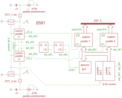

Now about the paddle related stuff:
Block diagram:

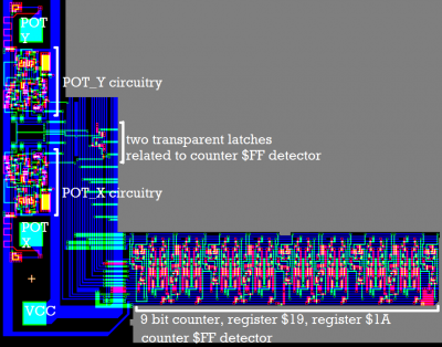

We have a 9 bit counter running at PHI2 speed.
Bit 7..0 from the counter are fed into two 8 bit latches, POT_X and POT_Y.
At the POT_X pin, we have an external capacitor, which is charged
through the paddle potentiometer resistance to +5V.
When the voltage at the POT_X pin has reached a certain level,
the value from the counter is loaded into the POT_X register.
Also, when the coutner has reached $FF (maybe because the paddle
potentiometer is missing), there is some circuitry that forces
loading the counter value into POT_X.
It's a 9 bit counter, while the counter MSB ( bit 8 ) is 1,
the external capacitor is discharged through a FET in the SID
which is close to the POT_X pin.
Same thing for POT_Y.
So one "conversion" from paddle potentiometer position to POT_X,POT_Y value
happens within every 512 PHI2 clock cycles.

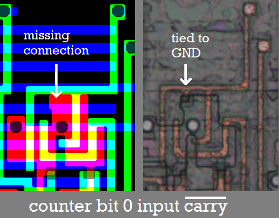

BTW:
To make the counter count, the low_active carry input of counter bit 0
is tied to GND. This connection is missing in the 6581 vectorized polygon
picture, but in the silicon it's there:
Edit: this connection only is missing in all the revisions of the 6581 polygon pictures.
In the 8580 polygon picture, the connection is there.

Then there are those two transparent latches between the register\counter block
and the circuitry close to the POT pins, delaying PDET by one clock cycle:

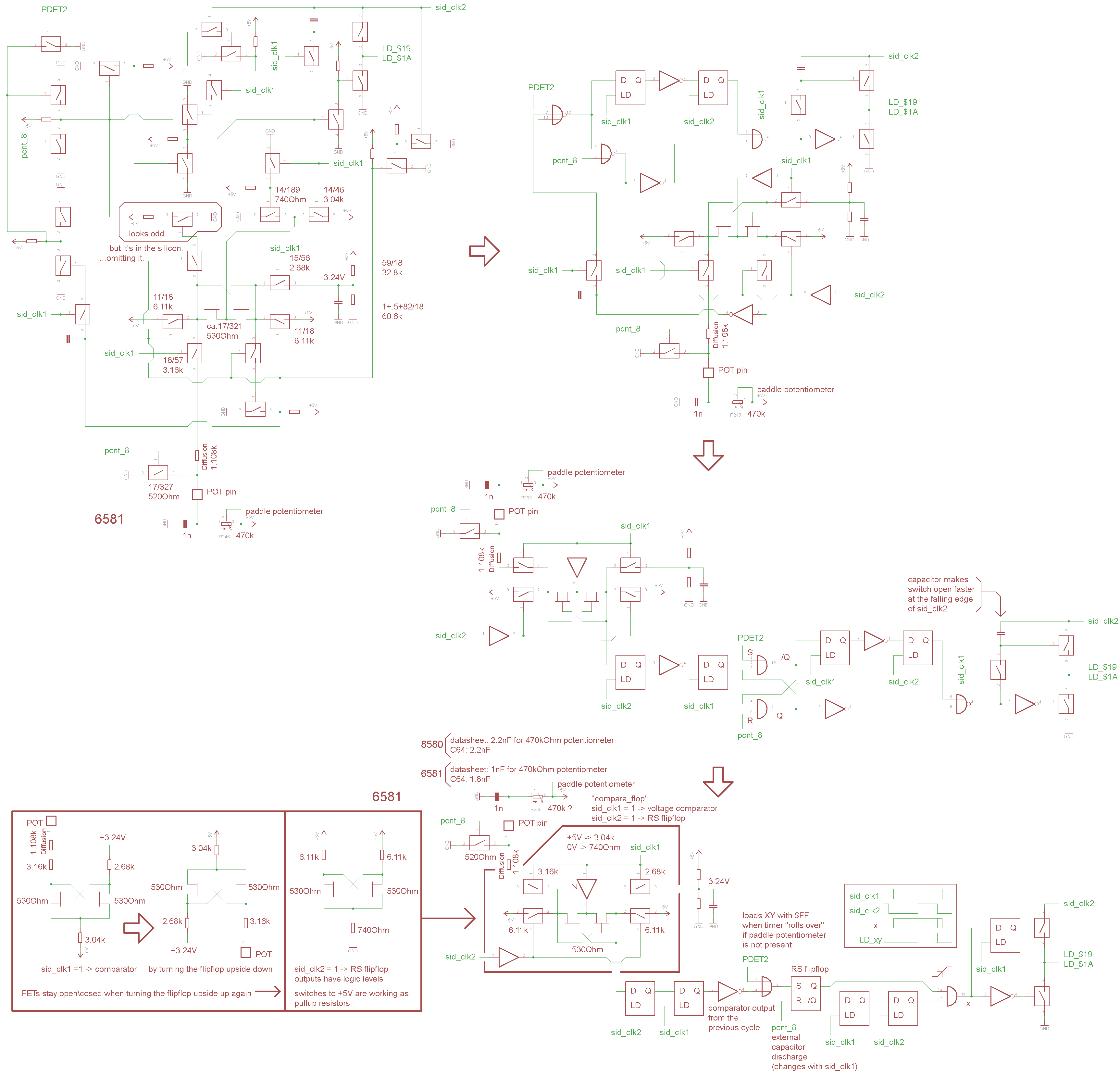

Those two FETs working as a voltage comparator during sid_clk1 =1
and as a R\S flipflop with logic level outputs during sid_clk2 =1
gave me quite a headache.
So much for the paddles.
Edit: July 2023:
It appears that there is an error in my schematic:

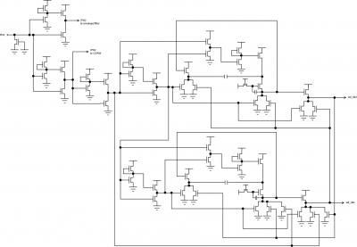

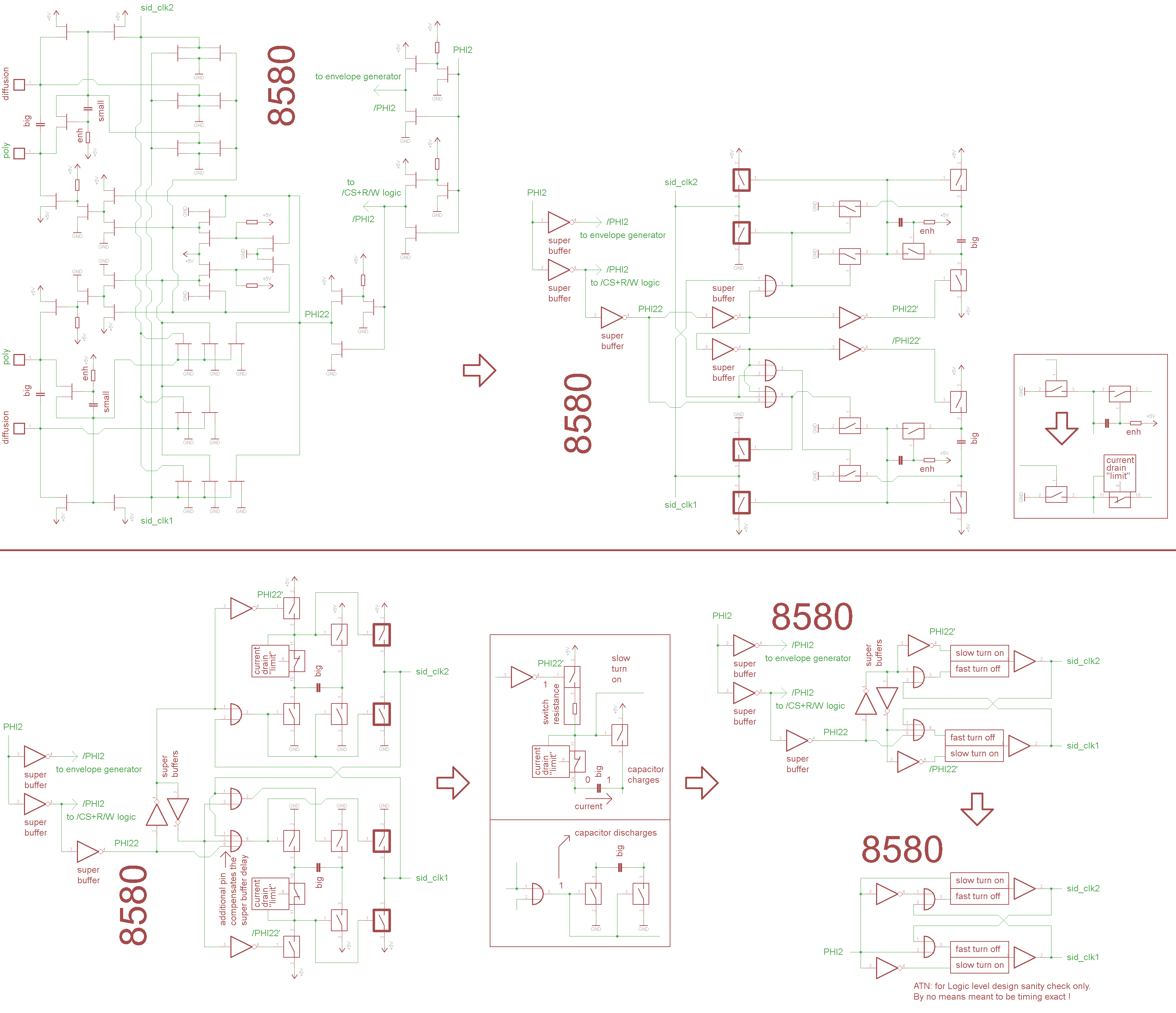

The 8580 clock generator is completely different from the 6581 clock generator.
I'm now posting my interpretation of it...
But if you want to be on the safe side, you better consult an engineer. :)
Anyhow, for simulating a SID or for building your own SID with TTL parts
it isn't neccessary to understand the clock generator.

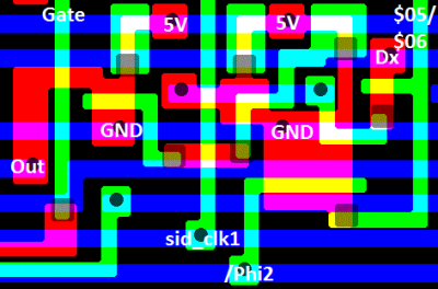

BTW: in the vectorized 8580 polygon picture, it appears that some part
on the diffusion layer was missing. In the silicon, it seems to be there...
it's just very hard to spot:
Edit: Message from drfiemost about the 8580 clock generator:
Althought arranged differently it looks like yours. I had verified it through the perfect6502 emulator, the only problem is that I had to short
the big capacitors and open the small ones as the analogic components are not supported. I hope this won't affect the validity of the result.

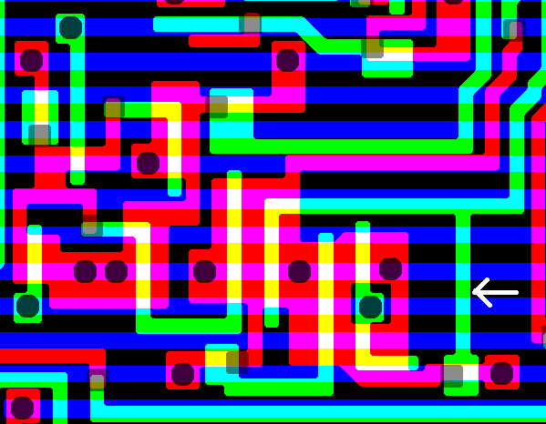

While dissecting the polygon images, we found two more bugs:
In the 8580, a part on the diffusion layer of the noise LFSR clock generator seems to be missing.
(all three channels)

What's wrong with the diffusion? Or is that image a 'repaired' image? Could you post a crop of the silicon for that area?
PostPosted: Mon Sep 12, 2016 12:27 pm
(I've posted about the general problem of polygon capture over here.)
PostPosted: Mon Sep 12, 2016 12:28 pm
Posts: 1431
The output of the NOR gate is unconnected, but I think it should be connected to the PolySi trace above.
It was drfiemost who had spotted this bug, and I can't remember exactly...
PostPosted: Mon Sep 12, 2016 12:35 pm
Goodness me, those edges are incredibly faint! But you must be right - the NOR output should go somewhere. (Unless it isn't needed.) Again, I think in the pre-simulation phase some of the bugs found are things like a logic input which is not driven by anything, which is a strong indication of a problem, or as in this case, a logic output not driving anything, which is a likely indication of a problem.
PostPosted: Mon Sep 12, 2016 12:54 pm
Posts: 1431
In the 6581, the output of the NOR _is_ connected to that trace.
The layout is different from the 8580 silicon, of course.
