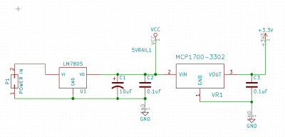

I'm working on my SBC's power design.
I plan on offering two power rails. One 5V and the other 3.3V. I have a need for both power voltages in my design.
I have built something similar to the attached schematic on a breadboard and it seems to work pretty well. At least according to my multi-meter. :-)
I welcome any constructive criticism.

PostPosted: Thu Aug 18, 2016 3:25 am
Posts: 8539
Make sure you do what the data sheet says about the 1µF input and output capacitors for the 3.3V LDO. LDO's can be tricky to keep stable, ie to keep them from oscillating. The designers have done the math and subsequent testing to give you the ranges and types of capacitors. You might save yourself a lot of grief by following them. I had an LDO in an aircraft intercom design 20+ years ago that worked fine in most aircraft, but in a few situations the aircraft's power source was exactly right to make it oscillate and damage itself, and I had to quickly re-do the board with a fix so it worked right for everyone. They have worked fine ever since, with no failures.

Posts: 8481
Other than Garth's comments about the LDO regulator's capacitors I see no reason why it shouldn't work.

Thanks for the recommendations. I will look at the datasheet and find the correct values.
Thanks!!
**EDIT**
I'm an idiot. It's right there in the datasheet. I've got to remember...it's ALWAYS in the datasheet. :-)
I will update the design but it appears you need a 1uF cap on the OUT and a 1uF on the IN.
For best results, mount both caps as physically close to the regulator as possible.

Final version.
Opinions appreciated.

cbmeeks wrote:
Final version.
Just for grins, make C8 a 100µF cap instead of 10µF. The physical size difference will be minimal and you'll get a little better regulation from the 7805 as loads on the 5 volt circuit fluctuate.

I have several 1000 uF caps. Do you think one of those should go on the switch?
I forgot to add the schematic for the switch so I should be able to update that soon.
Thanks
** EDIT **
Let me rephrase that...should there be a large cap supplying the "IN" pin of the 7805?
PostPosted: Thu Aug 18, 2016 7:42 pm
Posts: 8539
The data sheet also says you should have a capacitor on the 7805's input, really close to the regulator. For digital work where a jump of 50 or even 100mV won't matter, I don't think there's any point in going overboard on the output capacitor though since beyond a few µF the regulator's response will be quick enough to compensate for sudden changes in the load. That's not to say of course that you shouldn't have ,01 or 0.1µF bypass capacitors right at each digital IC, particularly if you don't have a ground plane and a power plane. (Copper pours don't qualify.)

The 7805 doesn't need a large cap on the input, as long as the input voltage stays above 7V or so (exact value can be found in data sheet).

I think I might go ahead and put a cap on the 7805 input line. This isn't going to be a high-volume production so I'm not too concerned on saving a few cents here or there.
All depends on from where the 7805 is getting its juice. If the basic source is sufficiently filtered, I'd say don't bother, as the 7805 is fast enough to filter out a reasonable amount of ripple.

More than likely, it would be from a 9V wall-wart that was regulated.

A cosmetic observation, but wouldn't the schematic be clearer if the GNDs were joined up? When I first glanced at the schematic I was a bit confused. I assume the two rails have a common ground; the net name is the same at both points. But for me this would look clearer if the grounds were joined with a wire.
What's the current draw? Don't forget the heat-sinks on those 78xx :)
