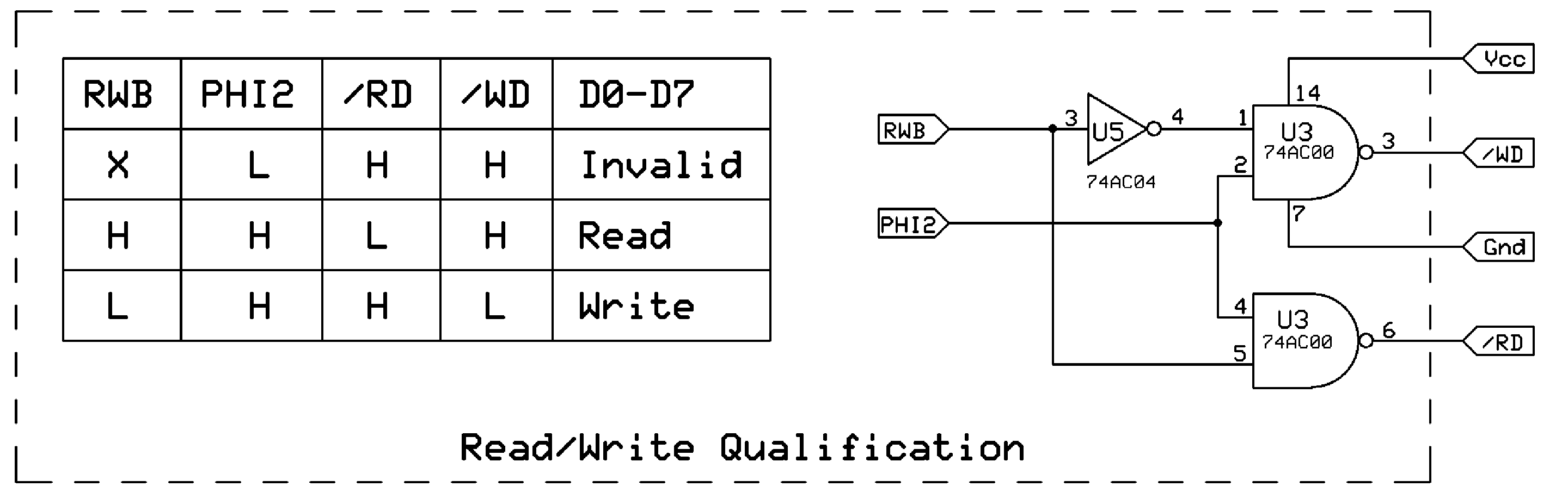

Thank you for posting this topic, I have tried to find SC28L91s. My local stockist only has the '92s and no longer stock the '91s. Looking through the datasheet it appears that both parts have the same pinout but the RxDB, and TxDB pins have been removed on the '91. I have pulled a design together based on the '92.
I'm just wondering if there is anyway to create a piggy back board that plugs into the 6551 28pin socket so I can get rid of them once and for all!!
Mouser Electronics stocks the 28L91 in TSOP. Dunno if that's a viable source for you.
I don't see why not, although the piggyback board would have to have some logic on it to generate /RD, /WD, the inverted reset, etc. The attached circuit generates /RD and /WD, fully qualified by Ø2. You can run your reset line through an unused section of U5 to generate the active high reset needed by the 28L9x.
File comment: Read/Write Signal Generation w/Ø2 Qualification
