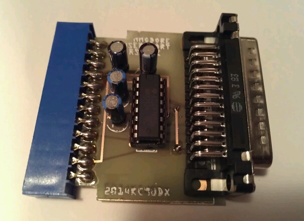

I don't want to hijack the conversation, but this is sort of on the original topic, as far as I can see:
Am I the only one making my own boards?
I have yet to have the silkscreening to turn out perfect, so they don't look professional, but otherwise I get good results. I don't know how it could get cheaper, but of course there is labor involved.
If you're only ever going to do one board in your life, it would be cheaper to use a professional fab shop. The initial investment is well over $100 for a high quality two-layer board. But they are dirt cheap after that.
If you're only ever going to do four-layer boards it probably doesn't pay either. I haven't attempted that yet, but it doesn't look easy.
I use the PCB Fab In a Box method. Sure, you can do the same thing without their stuff, but, I find it makes more sense in the long run to use their stuff. And no I don't have a pecuniary interest.
Prior to this, I masked boards with a resist pen in a CNC machine spindle. I've also milled boards. I've laid out boards by hand, too. None of those methods gave me results as good and as easy, though.
Something I found being discussed on another forum is some newfangled silkscreening kit for making T-shirts and things. I haven't looked into that yet, but that might be a possibility, too.

Here is the first board I made with the PCB Fab in a Box process.
It's not pretty, but it's far better than anything I did previously. Ones I made since then were much nicer.
