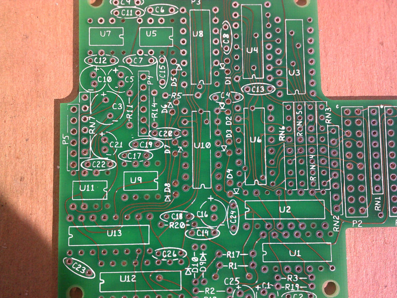

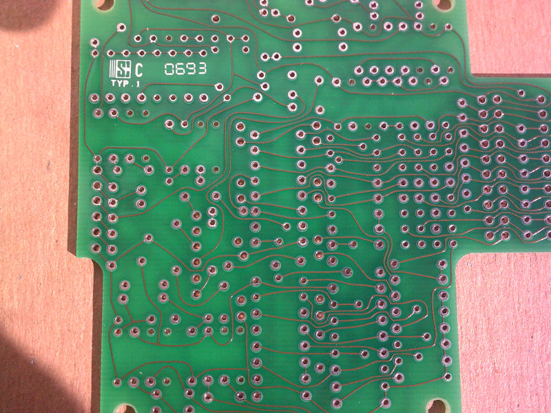

    Edit, 2022: I found the last board I taped, in 1993, at home for a job on the side, just before I got my own CAD:
    I think I threw out my box of crepe tapes and IC patterns and stuff just a couple of years ago, after not having touched it in over 25 years.<end edit>

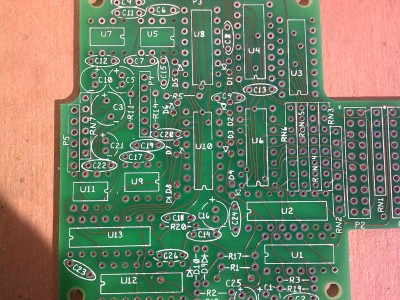

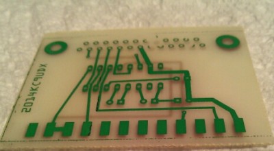

Here is the first board I made with the PCB Fab in a Box process.
It's not pretty, but it's far better than anything I did previously. Ones I made since then were much nicer.

Very nice boards you have done with your own methods. My experiences with producing my own boards have not been very exiting, that was about 30 years ago. I did a lot of etching. I used a lot of different methods like painting with water resistant pens, using tape and stencils for ICs or thermotransfer sheets. But all that was a lot of work and consumed a lot of time. I then switched to verowire and did almost all Projects with verowire, which is very fancy and even complex Projects did work quite well. I also have a NC milling machine and tried milling PCBs. Nothing was really satisfying.
If I take into account all aspects then I doubt very much that selfmade boards are cheaper than using a board house. Dirtypcbs will get you at least 8 dual layer boards with a size of up to 5cm x 5cm for 14USD including shipping. The boards have platedthrough vias and pads and a nice silkscreen and soldermask. You can even have your own shape, provided it fits into a 5cm x 5cm area. If this is not big enough then there is the 10cm x 10cm option for 25USD.
