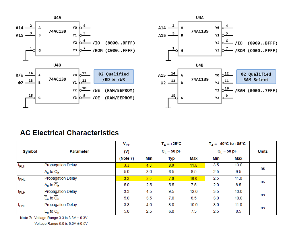

Hi Peter.
Looking at the TI Datasheets for 74AC00 and 74AC139, the propagation times at 3.3 volts seem pretty close. Perhaps you or another forum member could point out why using a 74AC139 in this application might be a problem, please?
TIA... Cheerful regards, Mike

Right you are the difference in prop delay for the AC versions are extremely small. I must admit that this was based on the figures I had in mind for the other technolgies (HC, LS, etc.). So yes the '139 would be a feasable single chip option.

Michael wrote:
A couple single chip solutions come to mind;
Michael,
I really like the idea of a simple one-chip decoder. When looking at your schematic, are you saying that I would pick either the left or right and not both?
Would you mind letting me know the pros/cons of either one?
Thanks
That's correct. You would choose either the ɸ2 Qualified RD/WR or the ɸ2 Qualified RAM Select circuit.
A third method involves driving the active-high chip select pin available on 8K, 64K, or 128K SRAM chips directly from the ɸ2 clock. The active-low chip select from the address decoder (the A15 address line in this case) would drive the SRAM active-low /CS and /OE pins while the 65C02 R/W line drives the SRAM /WE pin.
Speaking of single-chip solutions, Daryl Rictor (8BIT) has a very nice 22V10 Memory Decoder GAL available.
That's pretty much the same question I asked earlier. We see both methods used all the time. I'd really like to hear the conclusions and (qualified) opinions from our more experienced and knowledgeable members.

For moderate clock rates and decent RAM access times it does not matter. What I mean is that if the PHI2 high phase is longer than the sum of the delay time of the decoder, the '139 in this case, plus the access time of the RAM, plus the data set up time of the CPU, plus any delays of bus drivers if included, you can use a signal controlled by PHI2 to control the chip selects of the RAM. However in case the PHI2 high phase is longer than the sum you should consider a setup that creates the chip selects as early as possible. The reason is that many high speed RAM use the chip select to activate the address decoder and the access time from chip select to valid data is higher than the delay from output enable to valid data. This is because the RAM chips put the address decoder into a power save mode when the chip is not selected to save power. For systems with 32kbyte RAM I always use A15 as the chip select. Then also many non 65xx peripherals require a RD and WR signal that is asserted after the chip selects are asserted. Having a global RD and WR qualified with PHI2 then can not only be used to control OE and WE of the memory but as well be used for these peripherals.

@Michael
So, going by your example...if I used the scenario on the left (qualified by /RD, /WR), what prevents me from reading from ROM and RAM at the same time? What disables the RAM chip?

cbmeeks wrote:
@Michael
The A15 address line is used for the SRAM active-low chip enable ($0000-$7FFF) while the /ROM decoder output is used for the ROM active-low chip enable ($C000-$FFFF).

PostPosted: Wed Feb 24, 2016 7:49 pm
Posts: 1250
Ah, OK. That was the piece I was missing. A15 goes into the /CE of RAM AND the '139 mux.
While I admit I'm an uber n00b when it comes to this stuff, I can't find anything wrong with the design and I think it would be a great fit for what I want to build.
