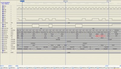

Work continues to verify all of the implemented instructions for the M65C02A core.
Below is an instruction sequence which demonstrates the Kernel/User mode of the M65C02A core. Bit 5 of the PSW has been designated as the Mode bit (M). By default the mode bit is set after reset, all interrupts, and traps/exceptions. The kernel mode stack is used to push the user mode PC and PSW. Only an RTI instruction may modify the mode bit, and only after the PC has been pulled from the kernel mode stack.
The first marker indicates the start of the code sequence used to push the address of the user mode routine and PSW. The middle marker designates the point in the execution stream where the transition is made from the kernel mode to the user mode. Leading up the transition, it can be seen that the stack pointer S (Sk) starts at 0x01EF and decrements as the three bytes are pushed onto the kernel mode stack. When the RTI instruction is executed, the values just pushed are pulled and Sk increments for each pull. After the last pull, when SYNC is asserted at the middle marker, the core is operating in the user mode, and the change in the stack pointer can be noted by a change in the value shown on the screen: from 0x01EF to 0x01FF. The first instruction in the user mode is a call (JSR) to a single instruction (RTS) user mode subroutine. After returning from the subroutine, the user mode stack pointer (Su) is transferred to X and compared with 0xFF. Since the test bench stops at an even address, the comparison passed.
File comment: M65C02A Core Mode Switch from Kernel Mode to User Mode
The following is a hand assembly of the test routine described above.

If the X register needed to be preserved, then the following code sequence can be used to test the stack pointer directly:
F264: 8BE0FF                cps #$FF            ; Su should be $FF after return

The following diagram shows the execution of a BRK instruction. The key take away is that the operating mode changes after the PC and PSW have been pushed onto the kernel mode stack: the M bit is set (PSW[5]), the D flag is cleared, and the I flag is set. The IRQ/BRK routine executed simply saves A and checks that P has D clear and I set, and then returns. After the RTI, the mode bit is clear, which means that the processor has returned to the user mode; also note that S is set back to 0x01FF as it was before the BRK instruction.
File comment: M65C02A Mode Switch from User to Kernel Mode Using BRK.
