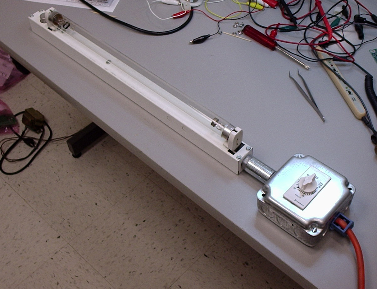

I continue to use UV-erasable EPROMs because they outperform most other types. I have about 20 of them around here and when I get down to the last few I put the used ones in my eraser. I don't have to wait, because I have erased ones still available.
File comment: Homemade EPROM Eraser
