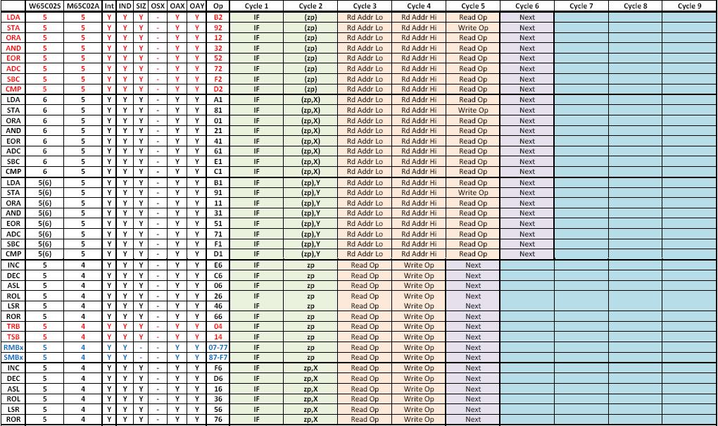

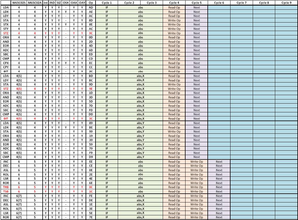

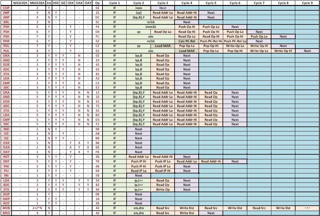

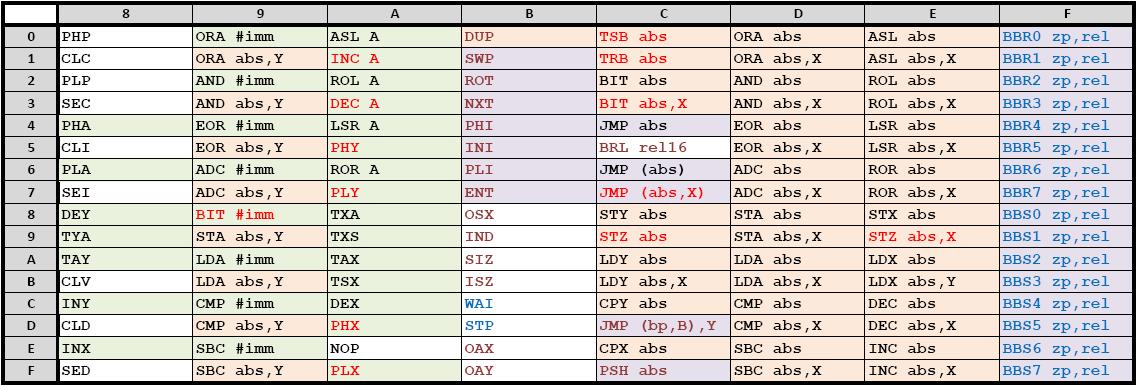

With the exception of virtual memory support, I have included all of the features into the M65C02A core that I wanted to include when this project started. Therefore, I believe that the end of this project has been reached.
My number one goal was the creation of a synthesizable core compatible with the 6502/65C02 instruction set, i.e. W65C02S-compatible, capable of operating from internal block RAM in a single cycle. My previous core, M65C02, met the W65C02S compatibility goal, but required multiple memory cycles to operate from internal block RAM. The M65C02A core can operate from internal block RAM in a single cycle.
My second goal was to reduce the size of the core's logic so that I could include support for additional addressing modes, 16-bit operations, and make the architecture more compatible with high level languages such as C and Pascal. A sub-goal was to maintain seamless compatibility with the W65C02S in order to execute 6502/65C02 code at any time. This goal has been met by a redesign of the ALU and address generation logic of the M65C02 core. Additional controls and multiplexers were provided in both of these components so that several new addressing modes could be added in a backwardly-compatible manner with the 6502/65C02. The redesign of the ALU allowed the M65C02A ALU to be enhanced to support single cycle 16-bit logic, shift/rotate, and arithmetic operations in virtually the same footprint as the ALU for the 8-bit M65C02 ALU with the limitation that BCD addition/subtraction operations are limited to 8 bits.
My third goal was to provide instructions to directly support a DTC/ITC FORTH VM. The M65C02A provides a number of instructions that allow the implementation of both DTC and ITC versions of the FORTH VM. The instructions are supported by the addition of a module in the M65C02A core that provides the Interpretive Pointer (IP) and the Working (W) register. It also supports the 16-bit operations on these registers which are needed to use them effectively. A new IP-relative addressing mode was added and supported by three instructions: LDA, ADC, and STA. These instructions allow speedier access to literals, constants, and variables. In addition, the IP-relative ADC instruction can be used to implement efficiently relative branches.
My fourth goal was to restrict the microprogram memories to the same two block RAMs used in previous implementations. The organization of the two microprogram ROMs have been changed significantly and expanded, but the microprogram for the M65C02A core only the requires the two block RAMs that all my previous cores have used. To achieve this goal, the microprogram sequencer/controller has had to be extensively modified so more efficient use could be made of the limited microprogram memory. In addition, several single purpose control fields in previous implementations now provide multi-purpose control of core elements that are not used simultaneously.

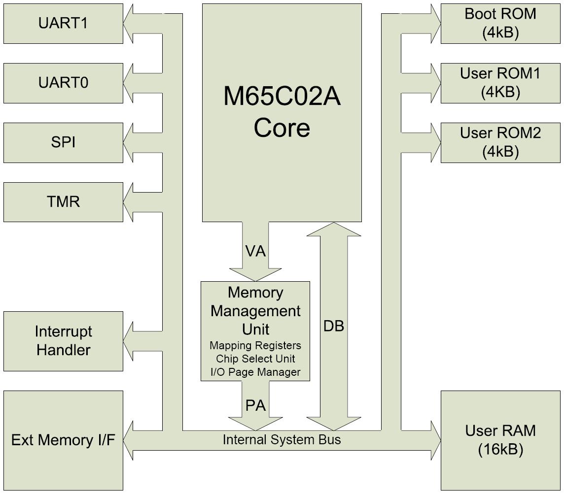

Finally, my fifth goal was to fit a microcomputer using the new core and sporting a simple vectored interrupt handler, a simple memory management unit (MMU), two buffered UARTs and a buffered SPI Master into the same Xilinx Spartan-3A FPGA used in my previous projects: XC3S200A-4VQ100I. I have several boards that have Spartan-3A/3AN FPGAs mounted, and targeting these parts sets the lower performance boundary for the core. Using the core with other FPGAs is simple and straightforward. I've avoided using any features that are exclusively found in one FPGA family and not another so to move to another FPGA simply change the selected FPGA and define the IO pins.

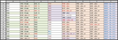

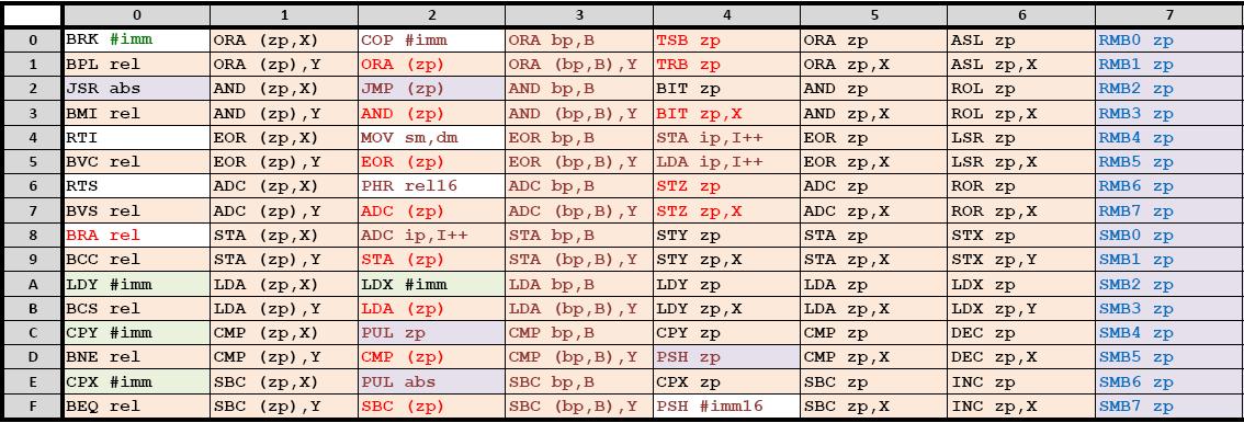

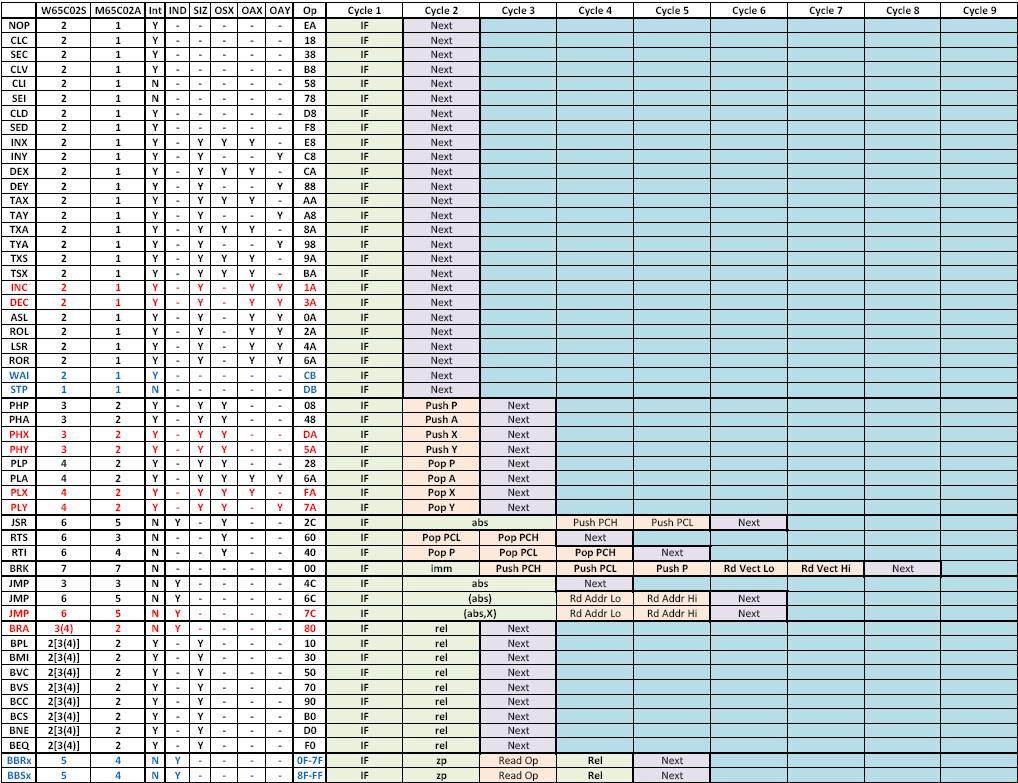

The following two diagrams provide an instruction set map of the M65C02A core. I've ordered the tables with the least significant nibble across the top and the most significant nibble on the left which results in the common layout. The M65C02A utilizes six prefix instructions to extend the capabilities of the 6502/65C02 architecture. In these figures, instructions using a black font are those found in the 6502, those shown in a red font are those introduced with the 65C02, those shown in a blue font are those introduced by the Rockwell 65C02 and the WDC 65C02S, those shown in a dark red font are specific to the M65C02A. It is difficult show the effects of the prefix instructions on these two diagrams, so only the effects of the IND, SIZ, and ISZ prefix instructions are shown in these two diagrams. Instructions unaffected by these prefix instructions are shown with a clear background, instructions that are only affected by SIZ are shown with a green background, instructions that are only affected by IND are shown with a purple/blue background, and instructions that are affected by all three are shown in an orange background.
File comment: M65C02A Instruction Set Matrix (x0-x7)
File comment: M65C02A Instruction Set Matrix (x8-xF)

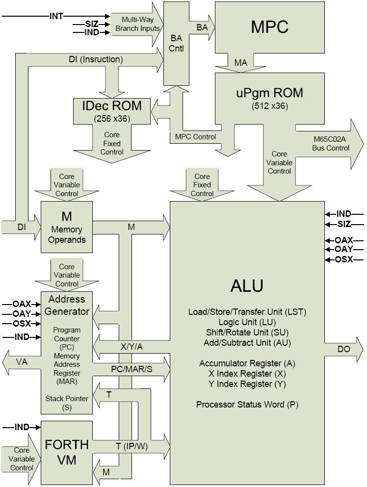

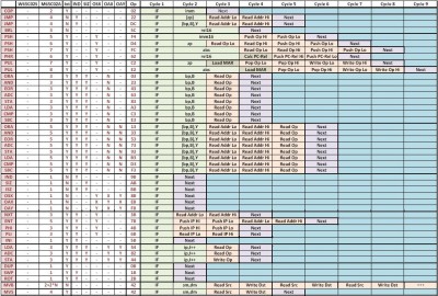

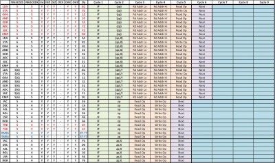

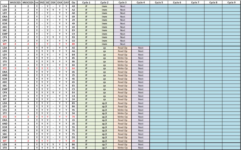

All 256 opcode slots are used in the M65C02A. The following five diagrams provide additional details regarding the instruction set. The columns labeled W65C02S and M65C02A provide the number of cycles each instruction requires. The column labeled Int indicates whether an instruction is interruptable (Y) or not (N). (The prefix instructions are not interruptable so that their effects do not need to be saved when interrupts are taken.) The columns labeled IND and SIZ indicate whether an instruction support indirection and 16-bit operations, respectively. (The ind instruction is used to implement secondary functions with opcodes that only use implicit addressing. In other words, instructions where ind can not have an affect on the address mode.) The columns labeled OSX, OAX, and OAY indicate whether an instruction supports one of the three register override prefix instructions. (osx swaps the functions of the stack pointer with X allowing stack operations to be performed using an auxiliary stack pointer maintained in X. osx also redirects register reads/writes to X to S instead. This allows S to use the LDX/STX/CPX/TAX/TXA instructions.) The column labeled Op provides the opcode for the instruction. The remaining columns define each cycle of the instruction.

Congratulations on your work, Michael -- you've clearly invested many hours in a highly ambitious project. It must feel great to finally release the result! :mrgreen:
That said, and with your HDL work done at last, I think the summary you've presented is still less than complete. What's important more than anything is for a newcomer to readily get a grasp of what the M65C02A can do. I supposes the various M65C02A related threads contain the necessary information, but it'd be nice if this thread were to review the main features one by one. In particular, the capabilities of the prefixes are central.
This part seems reasonably clear. What about the OAX and OAY prefixes -- should we assume the same reasoning applies?
IMO the most reader-friendly way to present this is to give each of the prefixes a brief paragraph. It'll be helpful to include a specific example of usage for each. For instance I don't understand what you said about the ind prefix; an example would help. And I don't see the ISZ prefix explained at all.
Incidental question: can you elaborate please regarding the instructions that are and aren't interruptable. For example JSR and RTS are listed as not being interruptable -- yet this is something I would take for granted. Any 65xx instruction must be allowed to complete before an interrupt can be permitted! I have a feeling I'm missing something.
It's nice to see so many single-byte ops that execute in a single cycle! Eliminating dead cycles is a significant performance boost in itself (not to mention 16-bit operations and Forth VM support). Is it possible to estimate a MIPs or MHz figure for the M65C02A?

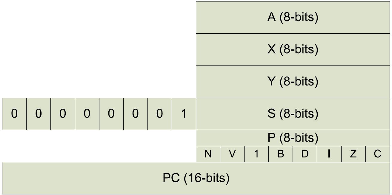

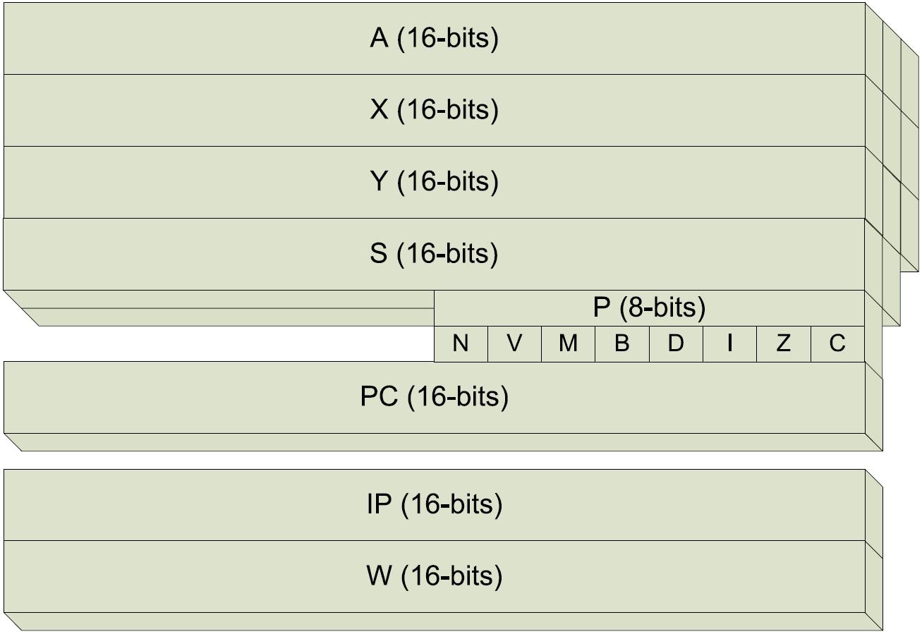

    (2)     M65C02A core allows the basic registers (A, X, Y, S) to be extended to
    16 bits in width. To maintain compatibility with 6502/65C02 microprocessors,
    the default operation width of the registers and ALU operations is 8 bits.
    Internally, the upper byte of any register (A, X, Y, S) or the memory operand
    register (M) is forced to logic 0 (except for S which is forced to 0x01)
    unless the programmer explicitly extends the width of the operation with a
    prefix instruction;

    (4)     M65C02A core’s X Top-Of-Stack register, XTOS, serves as a base pointer
    for the base-relative addressing modes: bp,B and (bp,B),Y. This addressing mode
    provides the stack frame capability needed by programming languages like C and
    Pascal, and which must be emulated by 6502/65C02 microprocessors. (Note: base-
    relative addressing using XTOS is generally associated with the system stack,
    but can be used in a more general way with any data structures in memory.)

To demonstrate the use of the M65C02A core, an example of its use to implement
a microcomputer is provided as part of the release. The example microcomputer
constructed using the M65C02A core provides the following features:
    •   M65C02A core (synthesizable, enhanced 6502/65C02-compatible core)
    •   a Multi-Source (16) Interrupt Handler
    •   a Memory Management Unit (with support for Kernel and User modes)
    •   28kB of memory (built from synchronous Block RAM)
    •   2 Universal Asynchronous Receiver/Transmitter (UARTs)
    •   1 Synchronous Peripheral Interface (SPI)

M65C02A-Specific Instructions
The M65C02A soft-core processor is fully compatible with all 6502/65C02
instructions and addressing modes. Regression testing using Klaus Dormann's
functional test suite executes without error. Unlike the mode switching used
by the 65816, the M65C02A uses prefix instructions. This decision can be good
or bad. It is good in that 6502/65C02 functions can be interspersed without
any concerns. It is bad in that it requires the programmer to explicitly
specify address indirection, register overrides, and operation size. In most
cases, the additional instruction length required to specify the various
prefix instructions does not result in poorer performance, or increased
program size because the strict 8-bit width of the 6502/65C02 processors
requires a lot more instructions to implement 16-bit operations.
This section will describe, in cursory detail, the various instructions that
are specific to the M65C02A soft-core processor. Only enough detail will be
provided to convey the character and behavior of the M65C02A-specific
instructions. Additional detail can be gleaned from the Verilog source code,
the microprogram listings, and the User Guide (under development).
##Prefix Instructions

The base-pointer (B) is X, and the offset included in the instruction, bp, is
zero based; this makes the value on the top of the stack offset 0. Further,
offset bp is signed so that positive addresses point to parameters of a
function, and negative offsets point to local variables. On entry into the
function, the current base pointer, X, is pushed, and then the stack pointer
is moved into X to mark the stack frame; offset 0 is the previous base pointer,
offset 2 is the return address, and offset 4 and above are the parameters
passed into function.
There are 17 M65C02A instructions using this addressing mode. There are eight
standard base-pointer relative instructions:
    ORA/ANL/EOR/ADC/STA/LDA/CMP/SBC bp,B
There are eight standard post-indexed base-pointer relative indirect
instructions:
    ORA/ANL/EOR/ADC/STA/LDA/CMP/SBC (bp,B),Y
These instructions support the IND, SIZ, ISZ, OAX and OAY prefix instructions
described above. IND, SIZ, and ISZ have the expected effects. When using OAX,
A becomes the base pointer, and X is the accumulator. When using OAY, A
becomes the post-index register, and Y is the accumulator. Since the base-pointer
relative addressing mode is not dependent on a stack pointer, the OSX prefix
instruction has no effect. The registers of the X register stack, especially
TOS and NOS, can be used to set up and maintain base pointers into the system
stack and into other memory structures such as the auxiliary stack, which is
also implemented with X.
The last M65C02A instruction supporting this addressing mode is a jump
instruction:
    JMP (bp,B),Y
This instruction supports the IND, OAX, and OAY prefix instructions. IND adds
a second level of indirection, OAX allows A to function as the base-pointer,
and OAY allows A to be used as the post-index register:
    IND JMP (bp,B),Y        =>  JMP ((bp,B)),Y
    OAX JMP (bp,B),Y        =>  JMP (bp,A),Y
    OAX IND JMP (bp,B),Y    =>  JMP ((bp,A)),Y
    OAY JMP (bp,B),Y        =>  JMP (bp,B),A
    OAY IND JMP (bp,B),Y    =>  JMP ((bp,B)),A
Recall that OAX and OAY are mutually exclusive. This constraint avoids the
non-sensical situation where OAX and OAY are both applied. This would result
in A being simultaneously used as the base-pointer and the post-index
register, which is not sensical.
##Extended (16-bit) Push/Pop Instructions
The M65C02A provides four push instructions and two pop/pull instructions not
found on the 6502/65C02 processors. These instructions push/pull 16-bit values
to/from the system stack:
    PHR rel16           ; PusH word Relative
    PSH #imm16          ; PuSH word Immediate
    PSH zp              ; PuSH word Zero Page Direct
    PSH abs             ; PuSH word Absolute
    PUL zp              ; PULl word Zero Page Direct
    PUL abs             ; PULl word Absolute
The PHR instruction resolves the absolute address of the 16-bit relative
displacement, and pushes that absolute 16-bit value onto the system stack. The
rel16 parameter is the distance from the address of the next instruction to
the target, i.e. relative to the PC. The stack used (SK/SU or SX) by this
instruction can be changed by adding the OSX prefix instruction. Other prefix
instructions have no affect on this instruction.
The PHR rel16 instruction can be used to synthesize a BSR rel16 instruction
using an instruction sequence like the following:
        PSH #$1
        PHR rel16
    $1: RTS
Another use of the PHR rel16 is to resolve, in a PC-relative manner, the
address of constant or variable needed at run time, when the program can be
relocated when it is loaded in memory. Using a base-relative LDA/STA
instruction prefixed with IND, the constant/variable can be accessed using the
pointer pushed onto the stack. Using the post-indexed base relative indirect
version of the same instructions, the constant/variable can be accessed
through the resolved pointer with indexing. Either technique can be used to
access objects in a position-independent manner using PHR to resolve the
address of the object.
The PSH #imm16 instruction simply pushes the 16-bit immediate constant
following the instruction onto the system stack. If the 16-bit immediate
values being pushed are addresses, then a better name for this instruction
might be PEA (Push Effective Address). The stack used (SK/SU or SX) by this
The last four extended stack operations support the zero page direct and
absolute addressing modes to write/read 16-bit values to/from memory. They
support the IND and the OSX prefix instructions with the expected results to
the addressing mode (IND) and default stack pointer (OSX). Other prefix
instructions have no affect on these instructions.

The following diagram provides a view of the M65C02A microcomputer that I've using to test the core. Neither the external memory interface nor the timer module are fully developed at this time; the external memory interface has been used for debug rather than for test programs. All programs written to date use the internal block RAMs as shown in the diagram.
The following two diagrams provide the Programming Model views for the M65C02A core in the 6502/65C02 compatibility mode and the extended capabilities mode.
M65C02A Programming Model - Extended Capabilities View.JPG [ 81.5 KiB | Viewed 2637 times ]

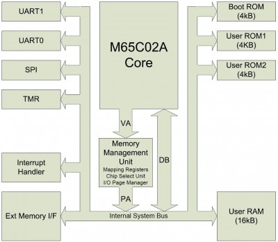

Finally, the following image provides a block diagram of the M65C02A core logic.
I continue to work on a comprehensive MS Word User Guide, but I've attached the document in its current form for those who may be interested. A lot of work remains. I've edited, re-edited large sections of the document. It's surprising how difficult writing a clear and coherent user guide for the M65C02A has been and continues to be. Virtually every time I open the document, I find something that needs to be added, clarified, or simply deleted. A lot more remains to be added, and I'll be working on that while I turn my attention to porting fig-FORTH, EhBasic, and possibly developing a simulator for the M65C02A.

One of the deficiencies in the M65C02A instruction set that became apparent as I was porting the code generation to the core was that the 6502/65C02/M65C02A lack a means to directly add/subtract values to the stack pointer. Even with all of the prefix instructions for register overrides that I included in the M65C02A, I did not include a way for the system stack pointers to be treated as accumulators. I reasoned that providing that capability for the X and Y index registers should be sufficient. However, allocating and deallocating local variables and function/procedure parameters is easily performed by the 8086 through direct manipulation of the stack pointer.
Since I did not have any free opcodes, I decided to replace the BSR rel16 instruction with a stack pointer adjustment instruction, ADJ. At first I thought that it would be implemented with an immediate operand, i.e. ADJ #imm, and could support the SIZ prefix instruction to extend it to a 16 bit immediate value.
That decision turned out to be rather short lived. In Pascal the function/procedure deallocates the parameters. This is elegantly done in the 8086 architecture using the RET N instruction, where N adjusts the stack pointer after the function/procedure return address has been pulled from the stack. In the 6502/65C02 this task is somewhat difficult. To make the penalty for using subroutines as low as possible, the number of cycles needed to remove the parameters from the stack must be kept to a minimum. My solution was to make the ADJ instruction use the contents of the Y register. This allows local variables to be easily allocated and removed, and function parameters to be removed in the calling routine by simply returning Y with the appropriate value and following every call with an ADJ instruction. This approach also works for C and other related HLLs.
