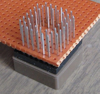

You don't even need to do that. Besides the common thru-hole soldertail PLCC sockets, there are wire-wrap ones available too (although the latter are quite expensive). See http://uk.rs-online.com/web/c/connector ... LCC+socket .
Note that these don't take any more board space than the PLCC sockets found on commercially made boards. Others here on the forum have come up with other ways to do the same thing with a little more work to save a lot of money. Jeff is one that comes to mind. Hopefully he will give a link to where he has posted pictures.

Here is a post detailing the PLCC-to-wirewrap solution that Garth mentioned. Actually two different but similar solutions -- "Plan A" and "Plan B"
"Plan C" is for SOIC's, but could be adapted to PLCC.
J. :)
