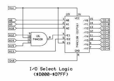

So the changes I made were to remove four of I/O slots and to move my 7-seg leds up to $7000. I can always remove them and add something else if needed later on. The reason I wanted them was to be able to output something before the uart was configured. I'm mainly a software person and love lots of debug output to help track down issues :)
You could fine-grain your I/O decoding a bit with relatively simple circuitry and considerably reduce the address footprint used by your I/O, viz:
File comment: Compact I/O Decoding
The above decodes eight I/O devices into pages, so the first device appears at $D000, the second at $D100, and so forth. Worst-case prop time at 5 volts is 14ns from the time the MPU asserts an address until one of the eight possible devices sees a chip select. I have a slightly enhanced version of that in my POC unit, which is stable at 14 MHz.

Why not give it more RAM? 32KB of ROM seems a bit much for most 6502 systems.
BigDumbDinosaur mentioned that the ST16C2450IQ48-F) is a bad choice for a DUART. I would like to stick with 2 UARTs, one for a serial connection to my laptop and one to have another device with. I was thinking of trying PICASO down the line.
I purchased one of the Picaso modules a few years ago, but decided that it would not make a good console display, mainly due to the lack of a hardware-generated cursor and an idiosyncratic programming model. It would be good for a kiosk type display, especially if using a touch screen. I ended up giving away the module.
At this point I'm leaning towards the SC28L92. The PLCC-44 isn't bad but a DIP package would be much easier. Wish manufacturers made more things in DIPs.
Relatively complex I/O chips like the 28L92 become quite bulky in DIP form. You haven't gone into any detail on just how you are going to construct your unit. If you are going to wirewrap or use a PCB, PLCC-44 is just as build-friendly as DIP, and takes up less space. When I laid out my POC unit I tried it with DIP and PLCC-44 packages for the MPU and DUART. I went with PLCC due to a substantial reduction in overall footprint of these two devices.

The data sheet I'm looking at has 74F11N as a triple AND gate - the corresponding triple NAND gate is the 74F10N.
That's correct. Better yet would be to use a 74AC10, which has about the same performance as the 74F10, but with lower power consumption, greater fanout and a slightly lower cost.
