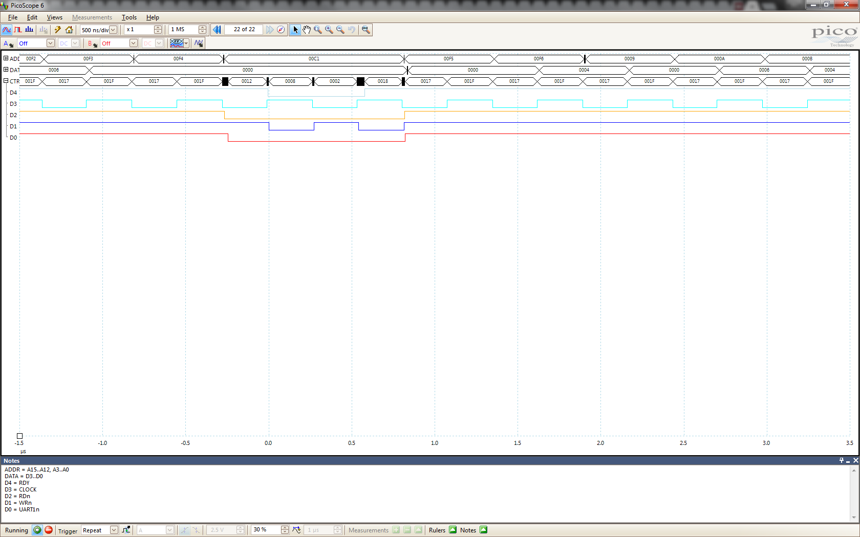

I made some progress fixing the WRn write pulse, but I seem to be facing a timing issue now.
Here is the logic analyzer showing the old timing before the fix. You can see the RDY signal is perfect, but the WRn pulse toggles with CLK which is not what the peripheral expects (key for which traces correspond to which signals is at the bottom of the window):
File comment: Wait state with incorrect WRn pulse
The above timing worked fine with the 68B50 UART, but that's probably just dumb luck and I don't want to take chances with the PMP on the PIC.
So I modified the circuit generating the WRn pulses and now I have this timing:
File comment: Wait state with correct WRn pulse
But unfortunately the system no longer works correctly. In particular, the PIC18 still programs the "ROM" correctly, but when control is transferred to the 65C02, EhBASIC doesn't work correctly. My best guess is that the tiny additional logic delay to the WRn signal is now late enough that the data lines have started to change while the write pulse on the CY7C199 memories is still low -- at least for a few nanoseconds -- which apparently is long enough to change their contents to other than what they should be.
When RDY is not asserted, the WRn logic works exactly as it did in the first diagram. The only difference now is that there is one more 74HC00 gate delay in the path of the clock signal. I could try to fix this by replacing the 74HC00 with a 74AHC00 gate, but I'd prefer to avoid going down that path until later when I want to push the speed of the 65C02 to the limit. Instead, I'm thinking that why not run the PHI2 signal through a couple of inverters and then use this delayed clock to supply PHI2 to the entire system, except for the WRn logic which can use the non-delayed PHI2 signal. I've used similar techniques on FPGA designs when they had to interface with external asynchronous devices with success, so it seems a reasonable path to go down.
If there is a better way I haven't considered, I'd be happy to hear of it. Hopefully something short of running a PLL that will allow me to implement arbitrary phase delays into my clocking signals though! :)
Edit: In the two images above, the logic analyzer output D2 is erroneously labeled as RDn (read strobe). It is in fact connected to the RWB pin on the 65C02.

Not sure if this will help you any, but here is the logic I am using in POC V2's CPLD to control the /RD and /WD signals:
RD        = RWB & (PHI2 # rdyout) & vab;       /* active low read            */
WD        = !RWB & (PHI2 # rdyout) & vab;      /* active low write           */
In the above, & is logical AND and # is logical OR. Terms are:
PHI2     system clock
RWB      read/write output from microprocessor
rdyout   true if a wait-state is being applied; active high
vab      true if valid address bus (65C816); active high
So, you need to logically OR the Ø2 clock with a signal that goes high (rdyout in the above) while a wait-state is in progress. The product of that is then logically ANDed with RWB to produce a valid /RD signal. Ditto for a /WD signal, except for the inversion of RWB. The result is that /RD and /WD will remain stable during the wait-state.

Here is the logic I am using for WRn (your /WR)
WRn = RW | (RDY & !CLK)
I believe this logic is correct (and the 65C02 doesn't have a VBA pin or equivalent so I can't use your logic without modification). I still believe I'm experiencing some sort of timing problem, since if I replace the above logic with this:
WRn = RW | !CLK
By removing one gate, the system works again. However, if I wire the RDY input high in the first equation, which produces exactly the same logic as the second but adds one gate delay, the system still fails.
What is defining the RW term? Please show me the logic for RW.
...and the 65C02 doesn't have a VBA pin or equivalent so I can't use your logic without modification.
Just rewrite the equations as:
RD =  RWB & (PHI2 # rdyout);  /* active low read  */
WD = !RWB & (PHI2 # rdyout);  /* active low write */
for the 65C02. While you are staring at those two equations see if you can identify a fundamental difference between what you are doing and what I am doing. Keep in mind that RWB is the MPU's output signal, not one generated by intermediate logic equations. This logic works glitch-free.
PostPosted: Thu Oct 29, 2015 3:27 am
Posts: 171
Location: Philadelphia, PA
Sorry I wasn't more clear. RW is the 65C02 RWB pin.
So, to restate:
WRn = RWB | (RDY & !CLK)
RDn = !RWB | (RDY & !CLK)
Where WRn is my active low write strobe, and RDn is my active low read strobe. Here I've used C-language syntax for nots, ors and ands. RDY is the signal level applied to the 65C02 RDY pin (low during a wait state), and CLK is PHI2. I stated earlier that I think this logic is correct, but that I had run into a timing issue based on the evidence at hand.
Looking more closely at the logic analyzer output (at a higher time resolution), it was apparent that the address bus had started to change before WRn (write strobe) returned high. The extra logic levels in the WRn path had finally added up enough to cause this problem. Since I'm using 15nS memory, it didn't take much for it to become corrupted. Fixing this was as simple as adding a single-gate delay to the PHI2 input to the 65C02 and all is working again.
I'm now seeing exactly the expected behavior for the RDY line and the read and write strobes on the logic analyzer and limited system testing with EhBASIC shows no problems. So hopefully I can now go back to testing the PIC-UART.

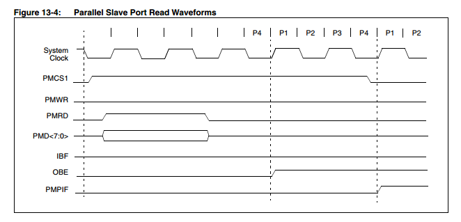

Spent some time testing the PIC-UART today and I think I'm ready to declare it beta quality. There's always more testing to be done, but it's working well enough to work with EhBASIC at baud rates up to 57600 and at 65C02 bus speeds up to 4 MHz (with 1 wait state, though I'm not sure that's really necessary at these bus speeds). To go further with testing, I'm going to need to write some dedicated machine language testing functions to push the performance envelope to the limit and beyond. If anyone knows of any easily ported file transfer software with error detection (e.g. xmodem), that would probably also be ideal for testing as well.
It sure is nice to be able to change baud rates without having to mess with hardware. Unlike the 6551, you're not limited to 19200 baud (max programmable speed), either. I gather there are a few hard-to-find DIP UARTs out there like this if you're willing to part with $20 or more for one of them.
There was one timing hazard in the software which proved to be difficult to fix. When you write to the PIC bus output registers, the PIC clears the flags indicating that these buffers are empty. A timing hazard comes about because the bus is accessed by the 65C02 asynchronously and if the PIC writes to those buffers during a brief window when a bus read has been initiated by the CPU but the ISR on the PIC has not yet been called, it will clear these flags. The problem is these flags are used to inform the ISR of which register was just read. I don't think the Microchip intended the PMP port to be used for this type of application, so it's a bit awkward to work with. The following diagram from the PIC24F reference manual serves to illustrate the problem:
File comment: PMP Timing
When the 65C02 initiates a read from the PIC, the OBE line becomes active four cycles before the interrupt is initiated (which itself takes several more cycles). Ordinarily, this would be a very small window for the hazard to express itself. Unfortunately, the portion of the code that writes to the output registers needs interrupts masked for synchronization purposes. If the 65C02 initiates a bus read while this mask is active, the interrupt code doesn't work correctly when it is invoked after interrupts are unmasked since the OBE line is cleared by the write to the output registers.

> It seems like a lot of hoop-jumping to avoid using a real UART
I think it's not so helpful to deny the premise of a thread. This thread is about using a microcontroller to emulate a UART.
I don't fully understand that race condition, but I see that it's a bit of an obstacle to making a reliable system. Let me try to summarise what I believe is going on:
- From outside the PIC, we want to read a register which the PIC is providing
- The (external) micro starts a read access
- The PIC gets an interrupt
- The PIC's interrupt handler starts up
- The interrupt handler reads a flag register which records which register the micro wanted to read
- The interrupt handler provides the data appropriate to that register
- The micro gets the data it wanted
The problem is that the same 'flag register' is used by the hardware to communicate to the interrupt handler which register is wanted, as well as recording which registers are full (not yet read) or empty (have been read)
If the non-interrupt code wants to place data into the output register, it needs to write to this same flag register, and this write can be in a race against the write the hardware does on an external read.
Can you instead arrange that the non-interrupt code places outgoing data into a circular buffer, and let the interrupt handler deal with moving data from the buffer to the output register?
