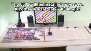

Here is the new plan to keep Vulcan-74 on track...
I have already removed the 65C02 and left a space on the board called "Cartridge Port". This is now a 16 pin port that has 15 address lines going to the 138 decoders, 8 data bits, and one strobe line. The strobe line is directly 6502 compatible, by tying it to the clock. So now any micro-controller or processor that can spare 16 IO lines can talk directly to the Vulcan Hardware. Being native to AVR assembly, and finding GCC easy to use, I will continue with the ATmega-1284 as my test platform, basing all other libraries from what I create here. Getting the AVR libraries ready will only take an afternoon of time.
I will be working on the Sound Generator hardware right away. This is why I made a second massive breadboard, as the Sound Generator will require at least 150 more logic ICs. Once the Sound Generator is working, libraries will be created and tested, completing the design.
The breadboard is only a proof of concept, and from there, I intend to make a permanent version in a cabinet. I have not yet decided between an actual PCB or a hand wired board on a massive perf. board. I may do both! The end goal is to create a massive E-Book (online and downloadable) on this project, but make it so easy to build that anyone can make one, even with zero experience. For this to be a reality, a PCB is really necessary, as soldering a point to point massive board is a skill only gained over time. No, I will not consider wire wrap. Most likely, I will hand wire my own version just to prove my schematics, and then order a few boards and make a second unit to prove the board. From there, I will make all PCB files available, a parts list, and tons of code examples and libraries for every processor (including 6502) in various languages. Having more time, I will try CC65 again. When it seemed like my ONLY option, I was not cool with that. Now that Vulcan-74 is compatible with anything that has 16 IO lines, it's all good.
So, back to having fun plugging in wires and working with a modern tool-chain!
Progress will once again move back into the fast lane!

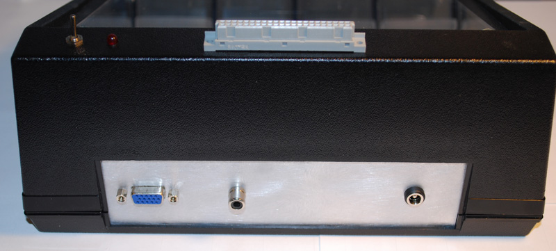

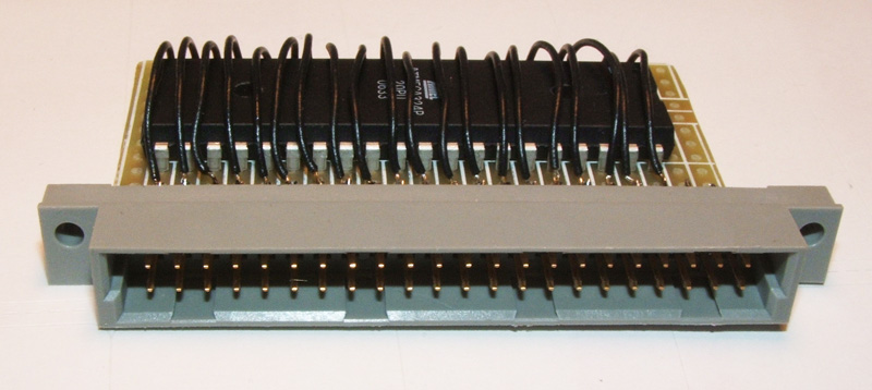

PostPosted: Thu Nov 05, 2015 3:43 pm
Posts: 690
Thanks Doc, that is a good point.
The cost difference between a 24 and 20 pin connector is next to nothing.
I will run VCC and GND at both ends.

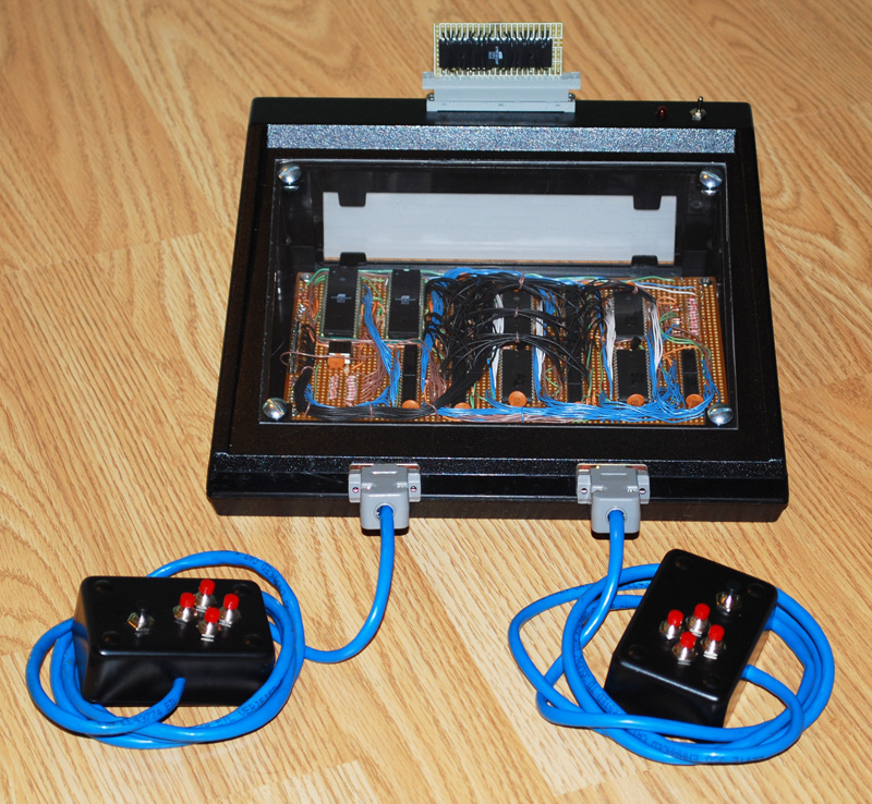

Way back when I built this simple Game system, I think I had dual VCC and GND as well. It was a while ago, so I can't remember the exact pinout.
I believe I built this one between 2006 and 2007, and it only used 70ns SRAM and 74LS parts!!
To get the required 10MHz VGA bandwidth, I relied on propagation delays that included 2 bits on the line at once!
In this unit, the "Cartridge" was also an external micro-controller, but a lot more data had to be transmitted through the connector since the mainboard was nothing more than a dual frame buffer. All graphics were drawn directly by the controller, seeing the board as a 64K SRAM only.
An external micro-controller was used as a cartridge on a 40 pin connector.
Homebrew joysticks were Atari / Commodore compatible.
Output was 256x240 VGA and mono 4 voice sound.
Any controller that could swing 16 address lines, 8 data lines, and 4 control lines could be used.
The 40 pin Cartridge link ran fine at 10MHz bandwidth, but it was a bit stiff to plug and unplug.
The new 24 pin Cartridge on Vulcan-74 will be much easier to use.
I did like the IDE connector though, it was very robust.
Again, thanks for your suggestion, I will certainly by adding dual power lines as a precaution.
Radical Brad

PostPosted: Fri Nov 06, 2015 1:07 pm
Posts: 690

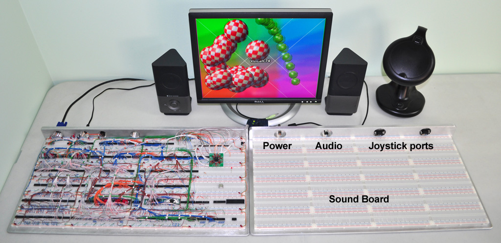

Dual Joystick functionality has now been implemented on the board.
Just a pair of 74HC245s that go active on the databus when the IO decoder drops their OE lines.
This completes the Video Section of Vulcan-74. The other board is completely open for the Sound Generator.
I will be doing one more demo program to exercise all Video functions and the Joystick ports.
From there, it will be the development of the Sound System.
Currently, the board looks similar to this, the only change being the addition of the 6502 compatible IO decoder and removal of the XMega.
A 40 pin DIP ATMega is now acting as the Cartridge during the final development stages, as I am comfortable with the C/ASM tool-chain.
The second board will contain the Sound Processor.
Some previous videos, showing the Sprite Generator and bitmap handling capabilities of the Playfield Generator...
https://www.youtube.com/watch?v=XuzK2BwvmKQ
https://www.youtube.com/watch?v=3fXuFCxMHVI
https://www.youtube.com/watch?v=CxonyIrZhDc
My next test demo will be a "physics" demo, showing a bunch of balls being dropped through a 512x2048 maze.
This will test several functions such as Playfield scrolling, direct memory reads (for collisions), Sprite Generation, and the Joystick.
.... until the next rain (or snow) day!
Radical Brad

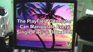

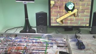

The Video System testing is now complete, and everything works perfectly.
For this test, I worked out all of the Video, Sprite and Playfield functions. These commands will be common to all processors and micro-controllers, making up what I call the Kernal routines. All routines will be optimized assembly for their platform, callable from the C main loop. Here are the AVR calls...
extern int GPU_Startup();
extern int ReadJoystick(uint8_t);
extern int SetMemory(uint8_t);
extern int DrawVideo(uint16_t,uint16_t,uint8_t);
extern int ReadVideo(uint16_t,uint16_t);
extern int SwapVideo();
extern int RunSprite(uint16_t,uint16_t,uint16_t,uint16_t,uint32_t);
extern int ReadSprite(uint32_t);
extern int DrawSprite(uint16_t,uint16_t,uint8_t);
extern int SetAlpha(uint8_t);
extern int RunPlayfield(uint16_t,uint16_t,uint16_t,uint16_t);
extern int SetPlayfield(uint8_t);
extern int ReadPlayfield(uint16_t,uint16_t);

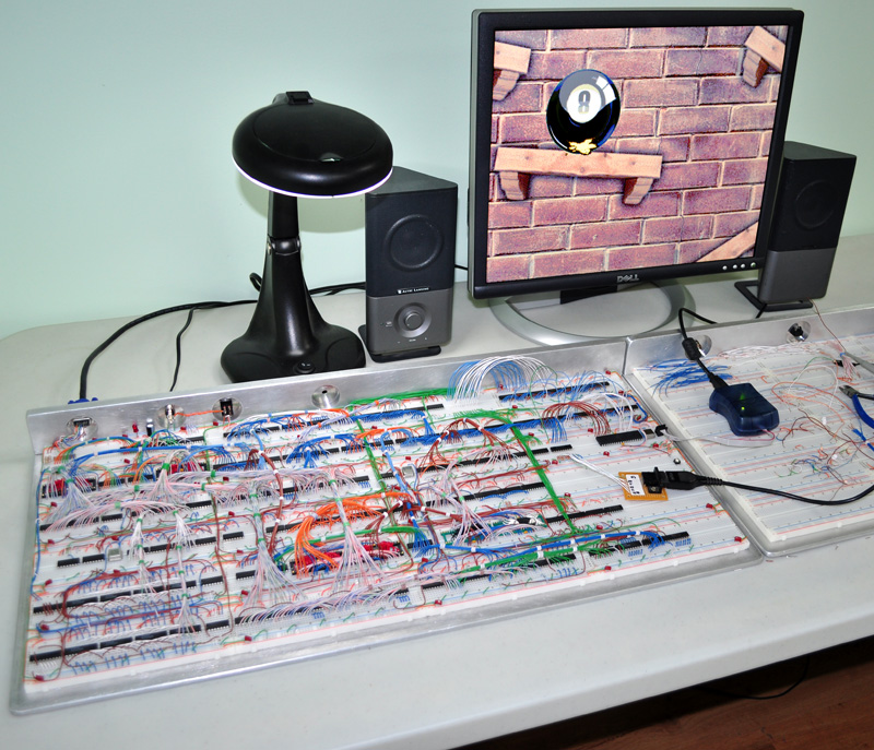

extern int DrawPlayfield(uint16_t,uint16_t,uint8_t);
This may not look like a lot of commands, but they offer a LOT of power for a minimum of overhead.
This command will use about 60 processor cycles, but can move a 400x300 image around the screen easily.
RunSprite(Ball_X,Ball_Y,Width,Height,8Ball[Rot]);
100 large sprites flying around (including alpha pixels) is no problem for the Vulcan hardware.
For this test, I decided to use floats for all variables, just to see if there would be any slowdown!
I gave myself 2 hours max to do this one, and that time included making the wall and 8-ball graphics in photoshop...
Here is a quick video...
https://youtu.be/HqSYwKYwtOo
60 frames per seconds was no problem at all, even dropping the AVR clock to 2MHz!
To make this code even more "inefficient", the collision between the ball and ledge is Raytracing in floats!!!
The background image is 1024x1024, and the sprite is 128x128 in size. No more balls next time... promise!
It's too bad that filming the screen looks so choppy and washed out, the real deal is so smooth and bright!
Pure floats, and raytraced collision detection!
