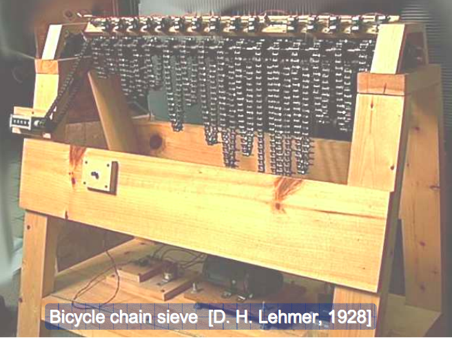

PostPosted: Sun Oct 04, 2015 3:35 pm
I wasn't quite so industrious, Klaus - only primes up to 10,000, which would mean up to 9973. So VTL can do much better than I did.
BTW, you might enjoy this prime sieve in physical form:
