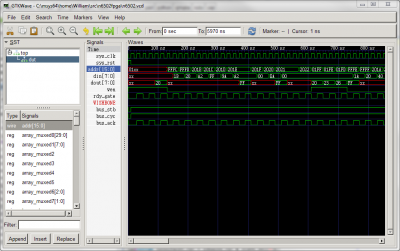

Okay, after some timing/simulation analysis of Arlet's core, along with looking on Arlet's website I think I figured out most of the internals:
Data is fetched on cycle X posedge, Data is interpreted on cycle X + 1 posedge, as indicated on the website. This pipeline allows Arlet's 6502 core to run at the full clock speed using only one edge of an FPGA clock. I think this is functionally equivalent to just shifting an ASIC's 6502 timing by one/half of a clock cycle and just having the address bus remain valid for longer than an ASIC core. It would be nice to see how ASIC 6502 cycles translate to Arlet 6502 cycles via a diagram though :P.
To prevent the pipeline from losing a cycle, write data becomes valid at the same time the address bus does, occurring the cycle Y + 1, immediately after the core realizes a write is going to take place, decoded on cycle Y. Contrast to an ASIC 6502, where data written is only valid after posedge (when address became valid on negedge).
To prevent the pipeline from losing a cycle to refill during absolute address writes/reads, the high byte is propogated directly to the address bus.
In any case, latching data in sequentially, tying RDY to wishbone ACK, and tying STB and CYC to the reset signal is sufficient to create a Wishbone interface at half speed (50 MHz to 25 MHz). All other signals are direct connections in Arlet's core.

Arlet wrote:
I'm a bit confused about the state of the RDY signal during all of this. Is it being deasserted ? And if so, can you show the timing ? (note that I have no experience/knowledge of wishbone)
RDY is deasserted every other clock cycle b/c wishbone (without more control signals than I have available) requires two full clock cycles per xfer to work properly. I would need this wait state regardless of the issue I describe in subsequent paragraphs, but not the latched DI. See attachment.
Arlet wrote:
User sleary78 opened an issue on github that had to do with RDY, and I think the core has a problem in cases where RDY is being deasserted, and the data bus is invalid. In those cases, the bad data is used to drive the address bus. https://github.com/Arlet/verilog-6502/issues/3
He closed the issue because he managed to find a workaround, but I still think there's a genuine bug in there.
I'll look into it and see if I can flush that bug out.
EDIT: The user seemed to have a bug similar to mine; he needed a delay element on DI to prevent the combinational connection of DI to AB from accessing a bad address. I needed it to prevent an infinite loop. The chance of needing this delay element depends on how your address decoding is set up. The core works fine AS LONG AS the only thing it's connected to is a synchronous memory, and presumably synchronous I/O. Unfortunately, my I/O is asynchronous by virtue of asynchronous address decoding, which is the root of the problem. Data is placed on the 6502 core's bus immediately, not waiting for the next clock cycle to drive the bus; additionally the synchronous memory's address decoding mux is deactivated, so it stops driving the bus too early.
It's not really a bug... just a design decision that has potentially unexpected consequences. Oh, and if you need this delay element like I did... yes, the clock speed is effectively halved b/c of the added wait state (my complaint about 2/3's was something unrelated that I managed to solve).

I think the problem is that the combinatorial path from data to address bus is maintained even when RDY=0, where instead you would expect the address bus to stay fixed at the same value when RDY=0.
See my edited post. I think what you just described is a side effect of the real issue.
