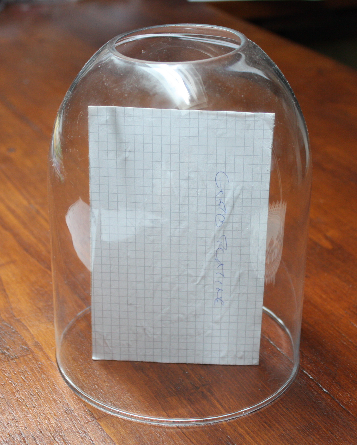

Case/outside:
I found a nice glass dome at during a trip to the furniture store with a big hole for warmth at the top to hold the computer. It's probably hard to judge the scale here, but it should fit one eurocard easily:
The cables would come in through the back/bottom, possibly with a shield on the back. Not sure yet, but my desk is all dark wood, so I'd try to make it fit in. (Yes, I bought two domes for when this one breaks. You learn to buy spares when you have kids and a cat in the house.)
You'll notice there is nothing here for graphics except for the LCD screen, which will be more an indicator if included at all. While experimenting with the ÜSq Mark Zero, I learned that for some reason I have no interest at all in graphics, and so everything will be via DUART to a "terminal" (my old white plastic MacBook, which is expendable if I fry everything).
So that's the idea so far. I'd be most grateful for any feedback and suggestions. Will try to get a schematic in the next weeks, but probably won't happen before May. Back to the garden ...
