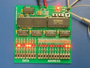

And now it is completely clear: the re engineered circuit diagram appeared online!
http://randomvariations.com/category/osi-300-trainer/
PostPosted: Sat May 30, 2015 1:34 pm
Posts: 10800
There was a little discussion over at
http://anycpu.org/forum/viewtopic.php?t=209
PostPosted: Tue Jun 23, 2015 12:28 pm
Posts: 10800
Worth noting that ChristopherB has used his redrawn schematic and made up a nice working PCB for an OSI 300 remake:
http://randomvariations.com/2015/06/22/ ... -300-mini/
