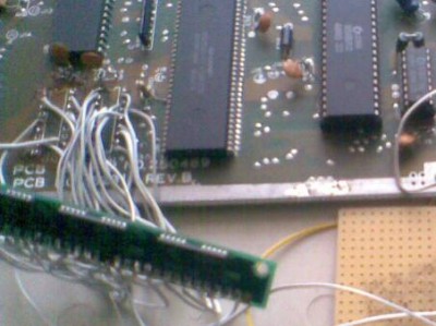

PostPosted: Mon Jun 15, 2015 4:21 am
Joined: Wed Feb 05, 2014 7:02 pm
Posts: 158
Forgive me for the stupid question, but in your PDF schematic, why are only 2 wires connected (A8/A9) to the SIMM connector? I think I'm missing something important here.
PostPosted: Mon Jun 15, 2015 7:23 pm
Posts: 3350
I know the feeling!
In this case, the photos in grzeg's lead post do a good job of explaining what's going on. The other pins on the SIMM do connect -- to solder connections on the PCB where the original DIP memory ICs previously resided.
ps: to grzeg: are you aware images can be hosted here on 6502.org as an attachment to your post? You may find this more convenient. Also it ensures they will remain permanently available in future.
PostPosted: Tue Jun 16, 2015 9:06 am
Joined: Fri Jan 17, 2014 6:39 pm
Posts: 47
Location: Poland
There already is 74ls173 (DUAL 4-INPUT MULTIPLEXER)
A8 because it really A8 / A18 and A9 => A9 / A19
Pin A10 (the scheme) is connected to ground if someone has applied Simm30 2MB or 4MB, in this case, would work as 1MB.
