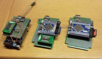

Wich SRAM are you using and how fast is the board running?
I have made 3 versions of this as Z80 running CP/M
One exactly as Grant have designed it on Cyclone II, one on Cyclone IV and one on Xilinx Spartan 6.
The Spartan 6 version have 64KB internal RAM and running at 135MHz :shock:
Jens

Welcome JensEP! Those blue boards look good, are they your own design or commercial?
If you like high performance for your Z80 core, you might see if you can swap out the T80 core for a NextZ80 core - it might not clock quite as fast but it uses fewer clocks for each instruction. See
They are from China:

Hi Jens
It is exactly as specified on Grant's site (uses the AS6C1008 as pictured) and it runs at 25Mhz which is fast enough (for now) given the limitations of the serial interface.
I would be very interested to see details of your board and VHDL. What I really wanted was something even faster (like what you made with the Spartan 6).
