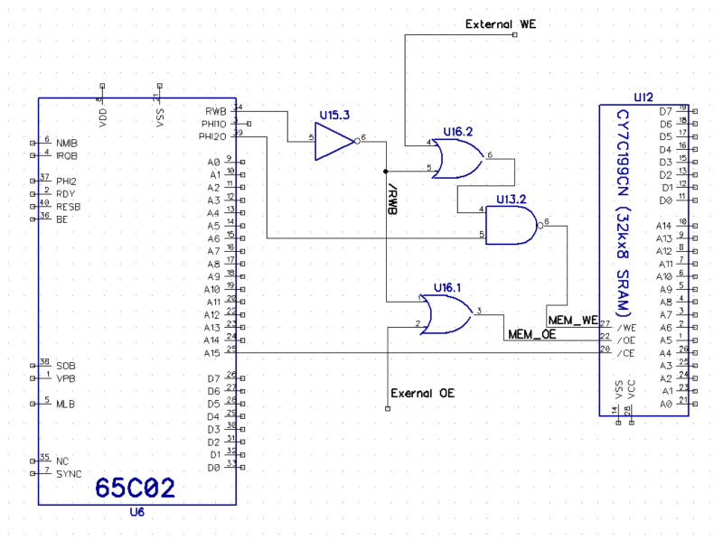

I am working on a small 65C02 based SBC, using some elements that are similar to a number of other 6502.org members approach of using a PIC/AVR to provide bootloading of the ROM.
I had a question about the timing requirements as it relates to a memory write. Assume I am talking only about the WDC65C02, not the older MOS 6502s.
First, a simple timing diagram. Increments (cells) are 5ns apart.
In looking at the datasheet for the 65C02, during a write cycle the output data lines are guaranteed to be active and valid at least 30ns before the fall of phi2, and 10ns after the fall of phi2. That is represented in the diagram in green. These are minimum values, and there are no listed maximum values.
Consider the simple (incomplete, just for discussion) circuit below:
Let's assume for discussion that propagation delay through a gate is 7ns. (74HCT)
In this circuit, the /WE pin on the SRAM is controlled by the NAND of Phi2 and /RWB (inverted RWB). That is also represented in the first timing diagram as MEM_WE in green. In this configuration, when Phi2 transitions happens, the SRAM will see the rising of /WE 7ns later. For this particular SRAM, the data has to be valid 10ns before the /WE rising transition, and 0 (ZERO) ns after the transition. In this case, there would be no problem. The SRAM effectivly clocks the data on the rising edge of /WE, but needs no hold over ( I would assume due to internal propagation in the design.)
All is good.

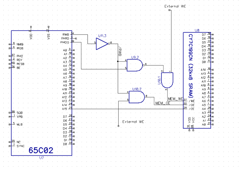

Consider an addition where I want to be able to read and write from that same SRAM via my PIC controller while the CPU is paused. Assume for this conversation that the CPU can be paused, and the BE raised such that the 65C02 will tristate it's output pins.
I first proposed the following circuit:
In this circuit, I added an additional AND gate in front of both the MEM_WE and MEM_OE signals. This would allow these external lines to control the memory (by going to 0), or let the CPU signal pass through (by going to 1). The downside of this approach is that it adds an additional gate delay to the signal AFTER the falling edge of Phi2. This is represented in the timing diagram as MEM_WE red. Since the two gates would add up to 14ns of delay, the rising edge of MEM_WE that the SRAM sees will happen 4 ns after the CPU data lines could potentially go invalid.
It is possible that this might just work, as the 10ns of data hold time is the minimum listed in the 65C02 datasheet... but I have no experience to say if that is true. It is interesting that this effect is not related to cpu clock speed, as the 10ns data hold time is a fixed value (at 5V)s. The only limitation is the delay from PHI2 to the SRAMs /WE.
An alternate fix is to consider this:
In this circuit I have moved the external AND gates behind the gates that mix in Phi2. In this case the falling edge of PHI2 is only delayed by one gate (7ns), thus the memory write pattern should work correctly. The only problem is that for this design to work, the 65C02 must be paused with the PHI2 in the high state, and the External OE and WE are inverted ( 0 - pass through, 1 - PIC assert ).
Is there anything obvious that I am missing here?

If all the loads are CMOS, the hold time will be potentially milliseconds or more, not just microseconds or nanoseconds, after the processor stops driving the bus; so you don't have to worry about that part. The time when write data becomes available needs to be referenced to the rising edge of phase 2 though, being no more than a maximum guaranteed time after the rise. Where it is relative to the fall of phase 2 then depends on the half-cycle time.

I can see that if I use the BE pin to disable the outputs that the loads will have long hold time, but I was more concerned with a CPU controlled write followed by a CPU controlled read, where the write data hold timing is close to the minimum hold time. Of course now that I think about it, a write cycle followed by a read cycle will be very similar, as the CPU will tri-state the data lines for input.... which will certainly give the SRAM plenty of hold time. A write followed by another write will also have plenty of time given the write output doesn't change until the rise of phi2.
Yea you are right about the write data (from the CPU) being 'available' on the databus is referenced from the rise of Phi2, and the datasheet specifies that as 25ns. If the clock cycle were so fast that that minimum SRAM setup time could not be met I would have problems. I see what you mean about where the 'start of data available' is relative to the fall of phase 2.. as the clock rate increases you will have less data setup time to give to the SRAM. That is a great point. Fortunately that isn't an issue with a 10MHz clock and SRAM I selected, since the setup time needed is only 9ns before latch.
I had seen those animated diagrams and they make the changes in clock timing very clear. Good stuff.
Since my only issue was the delay of the /WE signal to the SRAM relative to the databus changing for the next access cycle, I think this is going to work fine.
If I really need to have a complex (and high delay) path for the /WE to memory path, I could always put a buffer in front of the SRAM. That would add propagation delay to the data lines.. of course that makes the setup time more of a limit, but there is plenty of margin there.
Thanks for the input. Very helpful.

Some observations for your consideration:
  1. All timing in your circuit should be referenced to the Ø2 clock generator, whose output is applied to pin 37 of the 65C02. The outputs at pins 3 (Ø1O) and 39 (Ø2O) should not be used, per WDC recommendations. Note that Ø1O and Ø2O slightly lag Ø2, which can lead to subtle timing errors at higher clock speeds. Ø1O and Ø2O should only be used in cases where the 65C02 is being used to replace the NMOS 6502 in a circuit that was designed for the latter.

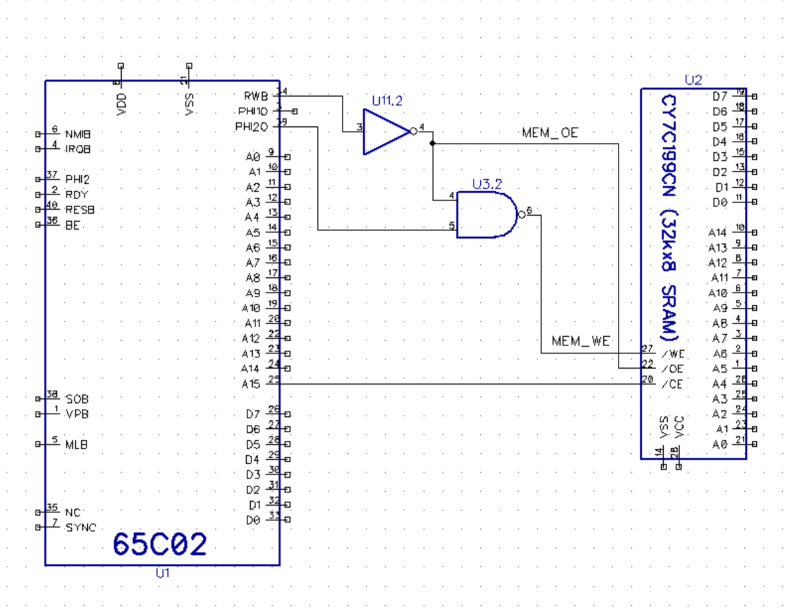

  2. Your read/write logic seems to be too complicated. Here's how I did it in my POC unit, which uses a larger version of the SRAM you are using, as well as other devices requiring discrete /RD and /WD signals:
    File comment: "Universal" read/write generation
    The above circuit fully qualifies RWB with Ø2, an essential requirement when non-65xx devices are attached to the 65xx bus. Note that 65xx I/O devices are slaved to the Ø2 clock and must see RWB and valid chip selects before Ø2 rises during a valid read/write cycle. That is, you must directly connect RWB to the equivalent inputs on 65C21, 65C22 and 65C51 devices, and must ascertain that chip selects on those devices are asserted before Ø2 goes high.
  3. Negating BE will put the 65C02's address bus, data bus and RWB output into the high-Z state, but will not stop the MPU. You would also need to negate RDY to actually stop the 'C02.
  4. 74HCT logic is not recommended in an all-CMOS design (the 'T' in HCT means TTL-compatible inputs). Most 74HCT devices are slower than their 74HC equivalents. Generally speaking, 74HC logic is only slightly faster than 74LS, which will limit the maximum Ø2 rate. I recommend that you use 74AC logic if you are intent on operating your unit at 10 MHz or higher. Aside from substantially shorter prop times, 74AC has more fanout than 74HC, which helps to compensate for the effects of parasitic capacitance.
As Garth notes, parasitic capacitance will cause signal states to persist for a while if everything on the bus goes high-Z. Most designs do not intentionally create such a condition—something is always driving the buses, so you have to be careful about depending on such an effect.
*Thank you* for pointing that out.... I skipped over that recommendation in the datasheet, so you saved me a lot of headache! Changing the schematic now.
  • Your read/write logic seems to be too complicated. Here's how I did it in my POC unit, which uses a larger version of the SRAM you are using, as well as other devices requiring discrete /RD and /WD signals:
  • Interesting. Part of my complication comes from wanting to also have the PIC able to drive the /OE and /WE ( /RD and /WR in your diagram ) of both of the SRAMS if the 65C02 is paused. Without that additional logic, my memory circuits would look like:
    which is even simpler. However your comments made me realize that if I pause the 65C02 (which is easy to do from the PIC since it is controlling the clock), and I use the BE pin to tristate the 65C02, the RWB pin will be tristated... so I can just hook my PIC directly into the same pin on the logic gates. Inside the PIC I can tristate my outputs before starting up the clock again. That removed he need for that extra set of AND gates I added.
    I'll make that change to the circuit.
    It is interesting that in your circuit you have the RWB and the PHI2 going into an NAND gate before going to the SRAM, while I have the RWB just being inverted before going into the SRAM. The difference is of course that in my setup, the /OE pin of the SRAM will remain driven (=0) until the RWB line goes low (as would be the case if the next operation was a write). In looking at the datasheet for the SRAM, if the /CE line is still active (say the next instruction is also a read from the same chip), the output data pins of the SRAM will never tristate.
    This mode is supported in the SRAM. In this configuration, if we assume the CPU is going to read from several hundred address in a row that are all in the same SRAM (say 100 NOPs), the RWB line will *never* go low and by extension the /OE pin and /CE lines will stay at 0 the entire time. The only changes will be to the address lines. I would assume that some SRAMS might actually need activity on the /OE line, but this one will work fine with no transitions at all (for reads).
    This would lead me to believe that it is not needed to NAND the Phi2 and the RWB, no?
  • Negating BE will put the 65C02's address bus, data bus and RWB output into the high-Z state, but will not stop the MPU. You would also need to negate RDY to actually stop the 'C02.
  • Ah yes.. fortunately since I control the clock from the PIC, I can just pause the whole thing!
  • 74HCT logic is not recommended in an all-CMOS design (the 'T' in HCT means TTL-compatible inputs). Most 74HCT devices are slower than their 74HC equivalents. Generally speaking, 74HC logic is only slightly faster than 74LS, which will limit the maximum Ø2 rate. I recommend that you use 74AC logic if you are intent on operating your unit at 10 MHz or higher. Aside from substantially shorter prop times, 74AC has more fanout than 74HC, which helps to compensate for the effects of parasitic capacitance.
  • As Garth notes, parasitic capacitance will cause signal states to persist for a while if everything on the bus goes high-Z. Most designs do not create intentionally such a condition—something is always driving the buses, so you have to be careful about depending on such an effect.
    Great input... in looking at the specs those ACs are a bit faster as well, so no reason not to use them. Since I am doing a PCB and not wirewrap, I suspect I can keep the noise down.

    I updated my SBC schematic to reflect changes to the read/write logic using the suggestions from above.
    This is how I have the /OE and /WR logic now:
    I moved to use the CLKIN instead of the Phi2 Output from the 65C02, and I have the /OE NANDed with the CLKIN. You can't quite see it on this picture, but the 65C02 clock input comes from the PIC microcontroller.
    In order for the PIC to read and write from the SRAM, it will stop the 65C02 while the CPU_CLKIN is low, pull BE low, the drive the address, data, and CPU_RWB lines as needed.
