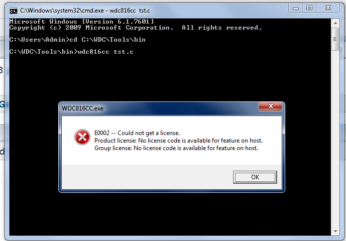

PostPosted: Sun Feb 01, 2015 7:18 am
Joined: Sun Sep 11, 2011 6:38 am
Posts: 13
Location: Singapore
wdc816cc.exe and wdc02cc.ex license error even on command line (Win7 home 64 bit).
Can I still purchase the license though its free?
PostPosted: Sun Feb 01, 2015 9:58 am
Posts: 996
Location: Berkshire, UK
I was disappointed by the WDC tools, especially the IDE and uninstalled it after 30 minutes. I think the download page should include some statement of what is free and what needs an extra license.
It looked to me like this was design for XP and is yet to be updated for Windows 7 and later.
