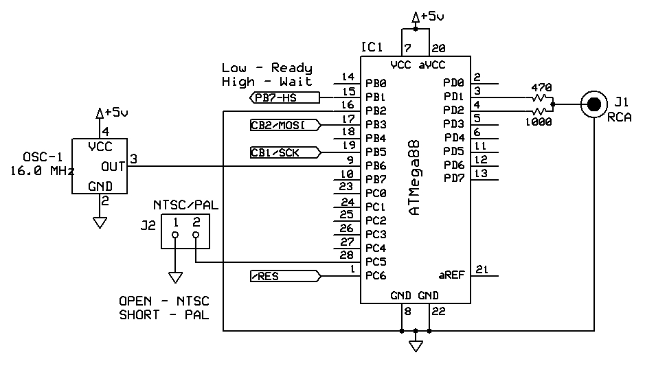

I have updated my Composite Text Video display to a newer AVR. The benefit is that it is fully functional using a single chip + oscillator.
It also uses an SPI input which can be driven directly from a 6522's Serial shift register (CB1 & CB2). A handshake line is connected to PB7. Maximum SCK speed is 4MHz. To support the 6522, I use SPI Mode 3 with MSB first.
NTSC and PAL are still supported as are several options for fonts - Old DOS, C-64, Pet, and Apple2 fonts are available.
Here's the schematic:
File comment: Schematic
The 6502 display driver looks like this:
; 6522 Definitions
Vportb    =  $0280      ; VIA1 Port B
Vddrb     =  $0282      ; VIA1 Port B DDR
Vsr       =  $028A      ; VIA1 Shift Register
Vacr      =  $028B      ; VIA1 ACR
Vifr      =  $028D      ; Via1 IFR bit 1
Vier      =  $028E      ; Via1 IER
; Output contents of A to the Video Display
;  A is preserved, Flags are changed.
VOutput
                bit  vportb                   ;  read handshake byte (pb7)
                bmi  Voutput                  ;  if pb7=1, wait for AVR to be ready
                sta  vsr                      ; send to display via serial port
VOutput1
                bpl  Voutput1                 ; if pb7=0, wait for AVR to ack
                rts
; Call this once to initialize the interface
; it sets up Port B, pin 7 and CB1/CB2 for serial mode
; A is changed and Flags are changed.
VInitDisp
                sei                           ; disable interrupts
                lda  Vddrb                    ; get ddr b
                and  #$7F                     ; force bit 7=0
                sta  vddrb                    ; set bit 7 to input
                lda  vacr                     ; get ACR contents
                and  #$E3                     ; mask bits 2,3,4
                ora  #$18                     ; set Shift out under control of PHI2 mode
                sta  vacr                     ; store to acr
                lda  #$04                     ; shift register flag in IER
                sta  vier                     ; disable shift register interrupts
                cli                           ; Enable Interrupts again
                rts                           ; done
I can provide pre-programmed AVR's to anyone interested in adding this to their projects.
