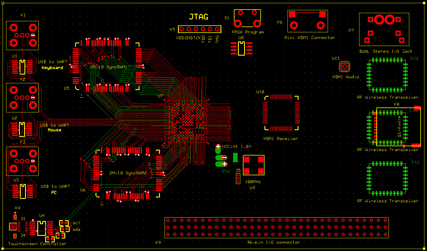

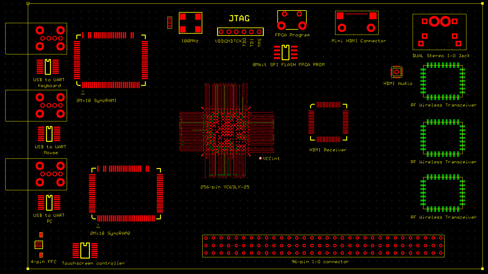

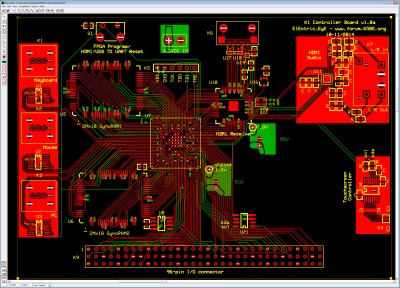

I decided to start a new thread on the Controller Board because I was having difficulty finding a decent camera module. In the end I decided to use an HDMI video input. This way a camera could be hooked up or any other HDMI video source outputting 1920x1080 @60Hz.
The IC I was looking at is an Analog Devices ADV7441. It is a video digitizer with the capability to handle many types of video inputs, even HDMI. It also handles the audio present in the HDMI stream. A very nice looking chip in a 144-pin QFP package, although I am prepared for a challenge.
EDIT: This IC is presently not recommended for new designs, so I am going to use an ADV7611 HDMI Receiver. It only has a single HDMI input and also can strip out the audio from the multimedia stream with the help of an SSM2604 audio codec. The receiver comes in an easy to handle 96-pin QFP package. There is a 1/8" dual stereo jack for audio out and audio in for experimentation with the audio codec IC. The audio codec is in a 20-pin QFN package.
There are 2 fast 2Mx18 SyncRAM's onboard as well, each with their own dedicated address and data buses. They can be used as video frame buffers, or maybe 1 as a frame buffer and 1 for sprite data.
It also has a 3 x USB to UART interfaces using the FTDI FT230X. Connections to a PC for file transfer, separate keyboard and separate mouse should be possible.
A DS1085L programmable frequency generator is onboard as well. It can be used in conjunction with the FPGAs PLL to generate virtually any frequency needed for the project.
A TSC2003 resistive touchscreen controller is onboard as well for experimentation.
At the center of all this will be a Xilinx XC6SLX25-3FT256, a 256-pin 1mm BGA, with a SPI FLASH PROM. Only 2 Voltages are needed for the FPGA, 3.3v for VCCaux & VCCO and 1.2v for VCCint. The FPGA will control the HDMI receiver, audio codec, touchscreen controller and programmable oscillator through a common I2C bus.
So the plan is to digitize incoming HDMI video into 24 bpp, take the least 5-6-5 bits from the RGB stream, mix it with the onboard videoRAM and then send the stream to 1 Parallel Video Board which will output the 1080p video through an older style VGA connector to an HD monitor. The original idea was to use at least 3 PVB's, but the pins were not there on this 256-pin Spartan 6. A successor to this K1 controller board will be able to control 6 PVB's. As it stands the 1 PVB will receive commands using an 8 bit parallel interface. Also, the controller board can choose which FPGA PROM the PVB should be programmed with.
Big dreams indeed, but I will take it one step at a time. The first step, after the board layout, is properly mounting the BGA and controlling the 1 PVB. Some discussion of how I will attempt this has already taken place.

EDIT: (11/10/2014) Redefined the goals, added board layout and .ucf constraints file.
EDIT: (11/12/2014) Added missing CLK signal to bidirectional interface in .ucf file

PostPosted: Sun Oct 26, 2014 5:51 pm
Today I tried to finish making custom IC & I/O Connector layouts in ExpressPCB. If all the IC's/Connectors fit within 21sqin, I'll commit my time to this design for production. Hopefully won't be 4 months like the last few boards.
It's preliminary...
The input power connector and VReg's (which will be placed on the bottom) are the only things missing at this point...
Initial fitment:

PostPosted: Wed Oct 29, 2014 12:18 am
About 2 more hours spent on connecting SyncRAM #2. Was able to move it closer to the FPGA. I went through about 3 iterations where I moved the RAM closer and closer to the FPGA.
This is one reason I'm not so keen on exact positions of the trace corners. Another reason is that I don't think they will even be visible on the produced board. I used to type the exact coordinates in by hand until there were no 'steps'visible in the diagonal, vertical, and horizontal traces at higher magnifications. It's not worth the time and effort to make it perfect, especially not this board which is pretty much a prototype...
What I do pay close attention to is minimizing trace length between the high speed SyncRAMs and FPGA.
Maybe another 2 hours tomorrow and SyncRAM #1 will be wired up. That would be a step up in my learning curve for this board!
Tonight I'll finish up the primary wiring from the FFC connector of the TSC2003 touchscreen controller in the bottom left. This is abit of a hack since I'm using a leftover touchscreen puchase from Ebay originally meant for a Kocaso m1050s Android tablet. There was no data sheet included, so no way to know if I'm correctly matching up X+, X-, Y+, Y-. I'll make it possible for the 4 connections to be jumpered at this point.

PostPosted: Thu Oct 30, 2014 12:17 pm
Posts: 258
Location: Southampton, UK
I am utterly inexperience when it comes to these kinds of devices, but I had always assumed that those kind of BGA packaged ICs needed a lot more then 4 layers on the board? What are the trace and via dimensions on the board?
Also, would a simpler FPGA do this job? BGA looks like it adds a whole new level of difficulty. Or is the choice "for the challenge" :)
It's a very interesting project. Are you going to encode the video in a particular format, or will it just write out raw frames? I trust you will keep us updated with your progress!
PostPosted: Thu Oct 30, 2014 8:40 pm
You're correct. In order to utilize all of the 'pins' more than 4 layers is needed. I am unable to route out about 22 'pins' so they are wasted...I wish I could find it, but Xilinx has a User's Guide for PCB Planning and goes in-depth on layers needed depending on package size (# of 'pins') and 'pin' spacing. The device I use has 1mm spacing.
I am using .006" trace width. Several different vias are used depending on if they are for power or signal. For signal, I use .026" with .008" hole. Power vias are larger.
Aslak3 wrote:
...Also, would a simpler FPGA do this job? BGA looks like it adds a whole new level of difficulty. Or is the choice "for the challenge" :)
Yes BGA is most definately a whole new level requiring more skills. I undertook this part of the project out of a need for more 'pins'. The 144-pin QFP package was very limiting for me when I was even designing the first Parallel Video Board with only 1 videoRAM and 16-bit videoDAC.
Aslak3 wrote:
...It's a very interesting project. Are you going to encode the video in a particular format, or will it just write out raw frames? I trust you will keep us updated with your progress!
Thanks alot, I enjoy the feedback!
For now, I envision just getting raw RGB pixel data sent from an HDMI device into the ADV7611 and output all 24-bits into the FPGA.
The first stage is for the FPGA to truncate some bits and transmit 5-6-5 16-bit RGB data to Parallel Video Board for output to an HD monitor that displays 1920x1080.
And now that I wrote this, I realize I won't be able to experiment with EDID, as the final ouput to the VGA connector is on a different board. Maybe the next version of the Parallel Video Board will include the scl/sda pins on the VGA connector necessary to communicate with the video monitor.
