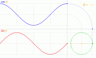

MichaelM wrote:
EEyE:
That's cool. I was reading and thinking about the integer square root function that Dr. Crenshaw published this weekend. Really impressed that it can be implemented succintly in Verilog as your code shows.
I hope to use it to control amplitude of the sin or cos table Xilinx has generated from LUTs and I've stored in BRAM.... Not sure yet. But I am borrowing the following .GIF from the sine wiki so the general idea can be seen, although I currently modify the phase for ellipse. A strictly horizontal or vertical ellipse requires amplitude modulation for the sin or cos.
