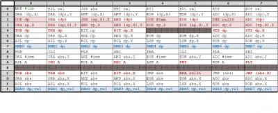

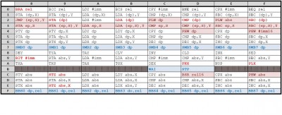

Completed testing of the M65C02A core's enhanced instruction set. The following two diagrams provide a map of the instructions as currently implemented.
File comment: M65C02A Enhanced Instruction Set Opcode Map: 0x00-0x7F
File comment: M65C02A Enhanced Instruction Set Opcode Map: 0x80-0xFF
Now the issue is how to add the features previously discussed that can be used to support a FORTH VM. Before continuing, I think that I'm going to wrap this thread up and start another that will be focused exclusively on what features and primitive instructions are needed to implement a fast FORTH interpreter with the M65C02A soft-core processor.
Several contributors to this thread have recently tapped on a thread in the FORTH sub-forum, 6519 Forth Processor. I am going to have to take some time to study the instructions in that microcomputer that support DTC FORTH.
Edit: added missing word, time, in the last sentence.
Edit: added link to GitHUB repository which has been updated will all the files for this version of the core.
Michael A.
