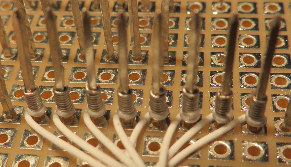

I would prefer at least 3/4". You want to make sure the turns between the ends have plenty of pressure kept on them. Make sure there's no gap between the turns, both to keep maximum pressure at the corners and so you can get the maximum number of turns and wires on a pin. Here again is one of the pictures on the WW page of the 6502 primer:

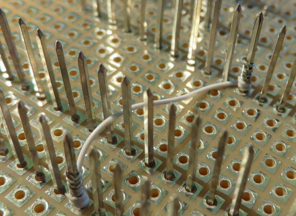

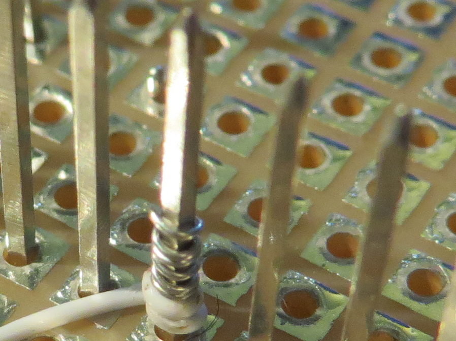

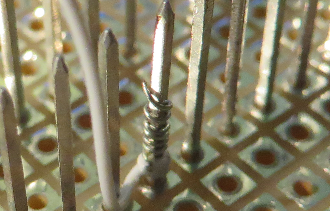

Here's my latest effort (see attached) - each image is at each end and I now get 000.0 Ohms :). It still doesn't look as perfect as yours, Garth, but I assume it'll get better.
Technique-wise, do you slowly bring the ww-tool up as you twist?

Ok, got it to look much better after starting again
No, I only make sure I'm not pushing down so much that wire starts going over previous turns of wire instead of onto the post. You will feel the tension go way up if the wire starts going over previous turns which happens if you push on it. There should not be any gap between turns though. As the primer says, good wire-wrapping relies a lot on the senses, and it's hard to describe the feel. Experience will get you there. The last picture looks great.
