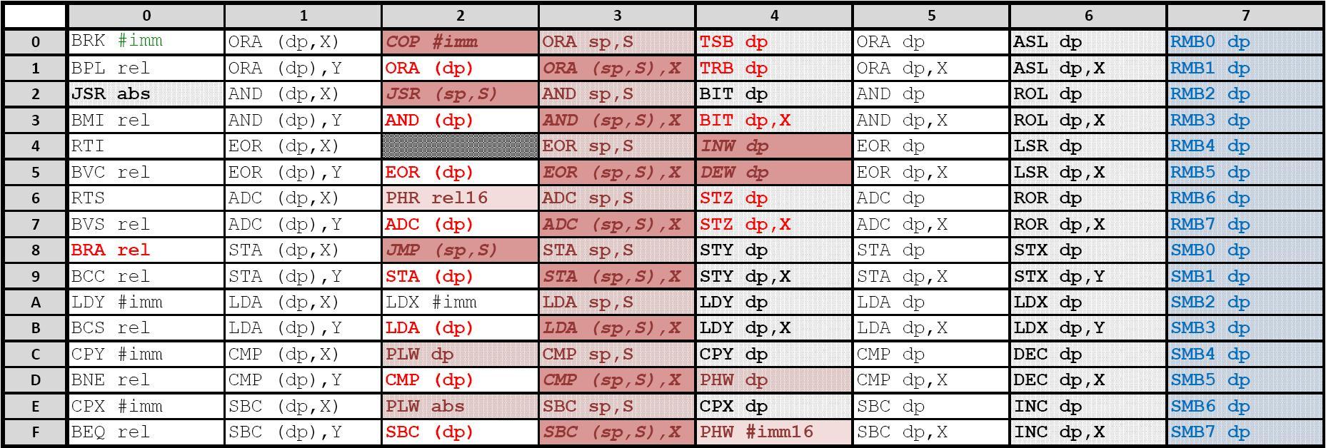

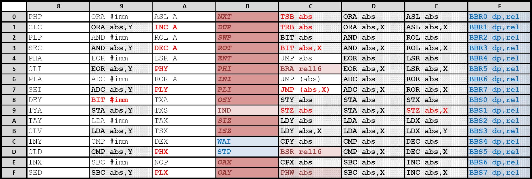

The college football season is almost over, so I've had some time recently to get back to my FORTH VM issue. After some noodling on this problem, I have settled on the approach that I'm going to take. I will add an internal module dedicated to providing internal IP and W registers. Not all of the issues have been resolved, but as Jeff suggested, including the IP and W registers internally will provide the best performance. It may lower the overall clock rate marginally because some of the additional multiplexers required are in the critical address path. However, the savings in terms of clock cycles more than offsets the small additional address path delay they introduce.
On the mapping of the FORTH VM registers onto the registers of the M65C02A, I've made the following decisions:
(1) I've decided that IP and W will be implemented internally as additional 16-bit registers.
(2) The Y register will be augmented with a modulo 64 stack pointer capability and used to implement the return stack. To mechanize these feature, a prefix instruction OSY will be used to override the normal stack pointer S with Y. Thus, everywhere OSY precedes a stack instruction, PHA, PLA, etc., the Y register will be used instead of S. The additional clock cycle penalty imposed by the prefix instruction is not particularly onerous given that the parameter/data stack is much more frequently used. The post-indexed stack relative indirect instructions will be modified to use X instead of Y as the index register. Y was chosen as the RSP because it is not as commonly used as the X register. Keeping Y as part of the stack-relative indexed indirect addressing mode would result in a lot of unnecessary saving and restoring of the RSP. This change uses the X register in a previously unsupported manner, but the stack-relative indexed indirect addressing mode is unique to the M65C02A. Therefore, with no existing tools supporting the mode for 65C02-compatible parts there's no reason not to make the change.
(3) The normal stack pointer S will be used as the PSP.
(4) Neither the A or the X register will serve as dedicated FORTH VM registers. This allows X to be used as it has been in 6502/65C02 programming, and for A to be used in a normal manner.
I've almost worked out how to extend the operation of the ALU to support 16-bit functions. As a consequence, I've defined two prefix instructions, SIZ and ISZ, to define an operation as a 16-bit load, store or ALU operation. SIZ will extend the instruction from 8 to 16 bits. ISZ will extend the instruction from 8 to 16 and also convert the addressing mode to an indirect mode. These two new prefix instructions supplement the IND prefix instruction implemented for the last release of the M65C02A core. Two other prefix instructions, OAX and OAY, allow A to be overridden by X or Y. These two prefix instructions allow the full capabilities of the ALU to be applied to the X and Y registers. An override of this type applied to the S was considered, but the lack of opcode space precluded its incorporation into the plan.
I am a bit partial to the stack-oriented ALU of the Inmos Transputers. I have designed several ALUs for use in my work that utilize that stack architecture. I've decided to at least incorporate a triple level stack in place of the M65C02A's A register. Depending on the effectiveness of that evaluation stack, I may add a triple level stack for X and Y as well. I expect the stack to reduce the number of load and store operations that are needed to perform computations. In support of this anticipated evaluation stack, I've reserved three opcodes DUP, SWP, and ROT to manipulate the evaluation stack. Each LDA will push the stack, and each STA will pop the stack. Arithmetic operations will operate as TOS and memory as currently supported by the 6502/65C02 ISA.
The FORTH VM will be supported by a number of single byte instructions: NXT, ENT, PHI, PLI, INI. NXT will perform the inner interpreter function. ENT will push IP onto the RS (PHI) and set IP as W + 2. ENT followed by NXT will complete the entry of the FORTH VM into the primitive. Exit from a primitive will consist of pulling IP from the RS (PLI) followed by NXT.
When used without the IND prefix, NXT will perform as required for DTC FORTH VM. When preceded by IND, NXT will perform as required for an ITC FORTH VM.
The stack-relative addressing modes should make the implementation of many of the fundamental FORTH functions much easier. Thus, not supporting additional FORTH primitives with dedicated instructions is not required given the expanded instruction set of the M65C02A.
I am interested in any feedback. The following two figures (transposed into the more common format) provides the planned expansion of the M65C02A instruction set to support ITC and DTC FORTH VMs:
Michael A.

It sounds very interesting, Michael, but I'm having some difficulty seeing a clear picture of how your modifications can be used in a programming context.
Would it be possible for you to share some sample code snippets, showing how your new instructions and addressing modes can be used to implement a simple benchmark, like Sieve of Eratosthenes, or some Forth core primitives, like (for example) + - AND ENTER EXIT @ ! DUP SWAP ...
Thanks,
Mike
PostPosted: Fri Nov 21, 2014 9:59 am
Posts: 10793
Very interesting work, Michael. I'd make one comment: for LDA and for arithmetic, converting registers into evaluation stacks is transparent. But a destructive STA seems quite a change. With your proposal, one would have:
STA is destructive
DUP; STA is the conventional store.
I would suggest retaining the conventional store, so you'd instead have
STA; POP is destructive
That would make it much easier to start programming the machine, from a 6502 background.
Having said which, I see there is no POP and also no room for it... and you'd need PPX and PPY as well.
Hmm. Perhaps you need to rename STA as SAP...

PostPosted: Fri Nov 21, 2014 6:33 pm
Posts: 10793
Ah, using ROT for POP, that's good. Not sure about LDA needing a DUP - but I know that HP changed their ideas about automatic stack lift, in the early days of their RPN calculators. There's more than one way to do it!

Lively discussion! :) Right now, Michael, I'll comment on your previous post only.
Kudos to you, and let me say how resoundingly right it feels to see serious priority given to Forth -- a chronically under-publicized language / programming style! Speaking of publicity, I'll grab this chance to trumpet the fact that the Philae lander for the ESA's recent comet mission is powered by a computer that runs Forth natively in hardware! There's a thread following this on the Anycpu.org forum (thanks, Ed).
Since I advocated for this, naturally I'm in favor of IP and W being internal rather than living in external RAM. Although the decision costs a few ns every clock cyle, the payback occurs not in ns but in much larger increments -- such as saving 4 entire bus cycles every time IP is updated (ie; no need to read then write this 16-bit value from/to RAM). And updates to IP are extremely frequent -- it's VM's "program counter," after all.
I'm not 100% clear on the modulo 64 part, but I certainly endorse having a prefix to allow stack operations via a register other than S. But do circumstances force you to use Y? Would it be possible to create a new register instead? That would allow you to avoid the (to me) unsettling changes in the usage for Y.
As with internal IP & W, obviously I am in favor. But, wow, it sure would complete the picture if the capabilities of the ALU could be applied to all three -- to S as well as to X & Y! 8)
It seems to me there's always a way to free up an opcode. The trick is to dream up as many possibilities as you can, then select the option that's best (aka least unpalatable :) ). I haven't had time to give this much thought, but here's the beginning, at least, of a list. To free up opcodes,....
  • - What if SED, CLD and maybe a few others ceased to use the "prime space" opcodes they do, and instead were demoted so as to require a prefix? Or,
  • - are there instructions you added very early in the project whose function is now largely supplanted by the cool new prefixes?
  • - have you wrung all possible functionality from the prefixes?
As a reminder I'll elaborate on that last point. If there are lots of combos (prefix plus target instruction) which are nonsensical or unimplemented, that's a sign of wasted potential. One remedy for that is to allow a prefix to have one meaning in regard to one group of target instructions, but a different meaning when applied to a different group of target instructions. That's the way each of the 8 bits of a legacy opcode work -- each bit is a chameleon, with a meaning that varies dramatically. If you begin with a conception about what every prefix "does" then there's a risk of overlooking useful possibilities, so I'd suggest trying to keep the approach general. The prefix need be no more specific than a 9th bit of opcode.

PostPosted: Fri Nov 21, 2014 6:39 pm
Posts: 10793
(CLV is underused too! It's worth noting that these instructions could perhaps be used as prefixes without losing their usual function. See my other post.)

Ed/Jeff:
Thanks for the thought provoking feedback. I want to maintain full compatibility with Klaus Dormann's test programs.
I can't see how redefining the behavior of standard 6502/65C02 instructions will allow that compatibility to be maintained. As has been demonstrated many times by many implementers, Klaus' functional test programs are an invaluable test for both FPGA cores and emulators. His test programs have help me uncover several obscure errors that my functional test program failed to identify. It will be difficult enough to test and validate the additional instructions of the M65C02A that I see regression testing with Klaus' programs as necessary.
I recently read somewhere, I'm thinking on the Heart of Forth website, that the FORTH standards recommend/require a minimum of 32 cells (64 bytes) on the return stack and 64 cells (128 bytes) on the parameter stack. Given that the RS would be allocated in zero page, I reasoned that making the stack mechanism perform in a modular manner similar to the system/parameter stack would be beneficial. Such behavior will tend to protect the zero page memory not allocated to the return stack. Thus, I decided that the least significant 6 bits of Y would increment in a modulo 64 fashion. The upper two bits would be available to define which of the 4 64 byte pages in zero page are allocated to the return stack.
With regards to this, I've moved to redefine two of those instructions, and they are to be used for adjusting the system stack pointer (S). There are of course the bit-oriented Rockwell instructions. Redefining them remains an option, but not if the M65C02A is to be instruction set compatible with the existing W65C02S microprocessor. I've included all four of the Rockwell instructions (32 opcodes) as well as WAI and STP. Since I made the Rockwell instructions support the IND prefix, there are actually eight instructions now supporting two addressing modes: zp direct and zero page indirect. I think that the new addressing mode will make these instructions much more useful. Also, keep in mind that I'm trying to keep the M65C02A as standard as possible in order to make use of available tools such as assemblers, compilers, and interpreters. Access to the features enabled by the prefix instructions will likely lag until someone (probably not me) adds the new instructions to a tool.
The quick answer I'm sure is no. I've considered doing what you point out below, but I will defer that until after the new definition is implemented and released.
--Edit: changed "code block into quote block
