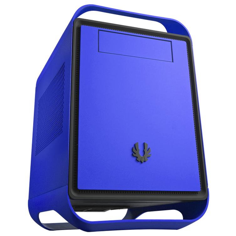

Looks like it's time to get 'er done. BTW, how did you come up with the Blaufuchs name for the project?
All my projects have "codenames", (Blaufuchs = Bluefox).
I think when I started this one I felt a bit "blue", so it had to be something blue. After stumbling upon a blue ITX cabinet I decided on the name Blaufuchs. :-)
