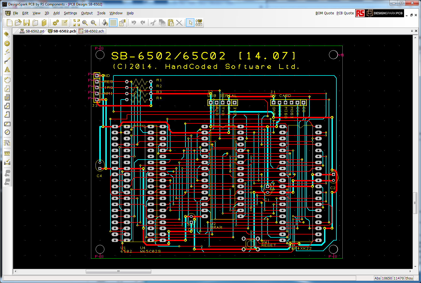

A few days ago I put in an order for some PCBs like this.
File comment: SB-6502/65C02 PCB
I will be putting SIL sockets on the board so I can fit either chip. There are headers for a PL2303 USB connection and an SDCARD module. My PIC firmware emulates an ACIA and an SPI65.
