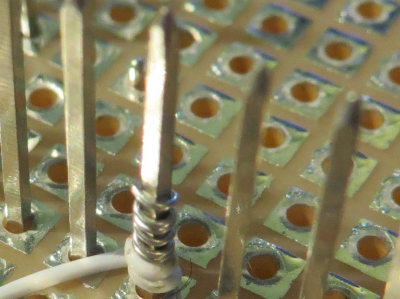

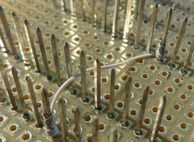

Here's my latest effort (see attached) - each image is at each end and I now get 000.0 Ohms :). It still doesn't look as perfect as yours, Garth, but I assume it'll get better.
Technique-wise, do you slowly bring the ww-tool up as you twist?

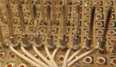

Ok, got it to look much better after starting again

No, I only make sure I'm not pushing down so much that wire starts going over previous turns of wire instead of onto the post. You will feel the tension go way up if the wire starts going over previous turns which happens if you push on it. There should not be any gap between turns though. As the primer says, good wire-wrapping relies a lot on the senses, and it's hard to describe the feel. Experience will get you there. The last picture looks great.
