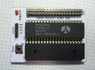

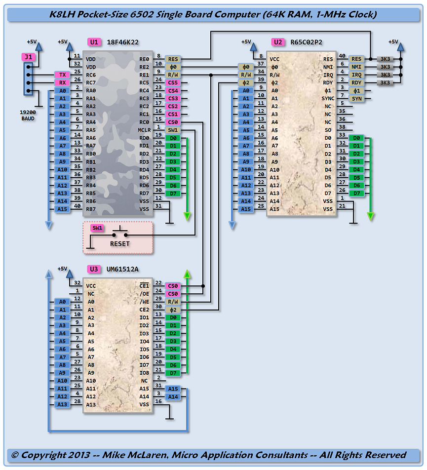

Nothing really new or particularly clever on my part (it's pretty much all been done before), but it's my first ever SBC design so I'm pretty geeked.
This is basically a ROM-less SBC with an R65C02 CPU running at 1-MHz, a 64K RAM chip, and a PIC microcontroller "helper". The PIC provides the 6502 reset and 1-MHz clock signals and it loads RAM during power-up or after a reset with a pseudo ROM image from flash memory. The PIC also eliminates the need for a GAL or other discrete logic ICs for address decoding by implementing a soft decoder with single page resolution for up to six chip select pins. The soft decoder also maps the PIC UART to a single page in 6502 address space and the UART presents to the 6502 as a simple 6850 ACIA.

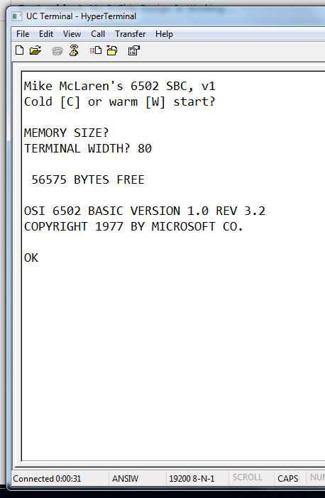

To test the SBC I modified the soft decoder 256 byte "decoder map" to fill the 64K address space with RAM, except for the $DF page where I mapped the UART (pseudo ACIA). I also uploaded Grant Searle's ROM image of OSI BASIC + Monitor into PIC flash memory and this image is copied into RAM at $E000-$FFFF during start-up. Everything works great!
I'm in the process of moving the design from a solderless breadboard to a 2.0" x 2.75" prototype board and there's lots of work left to implement a "supervisor" mode on the PIC to allow uploading decoder map and ROM image files via the serial port into flash memory.
This SBC design is the result of help and inspiration from many sources across the internet and here at 6502.org.
Cheerful regards, Mike

Can I ask you to elaborate on the PIC, please. For the address decode function, is the PIC actually inputting the 6502 addresses and -- in software -- testing for matches and updating chip selects (or UART access) in response? A tight loop accessing a lookup table, perhaps? :) The clock rate would need to be pretty high... several times faster than the '02, at least.
I like the idea of a pseudo ROM: RAM loaded with an image from flash memory!
PostPosted: Tue Feb 04, 2014 5:10 am
Posts: 586
Hi Jeff:
My address decoder method uses an array of 256 bytes with the high byte of the address buss (b15..b8) as the array input (index), representing pages $00..$FF, and each element in the array contains the bit pattern for the six chip select outputs (port C, b5..b0) for that page. So, each chip select output has 256 bits spanning the array (or "decoder map", if you like), one bit for each memory page, that defines its state for that page. The PIC is running much faster than the 1-MHz clock it's producing, and since it's producing the clock, it knows exactly when it can sample valid address data each cycle. The PIC has just enough time during each 6502 cycle to read the address and use it as an index to copy the correct element from the array or "decoder map" onto the chip select outputs.
Does that explanation help?

How are you using the Pic's uart from the 6502? Does the Pic's decoder code know that certain addresses go to the Uart instead of ram?
The PIC UART is mapped into 6502 address space much like any other device, except that PIC I/O doesn't require an external chip select pin. The decoder maps eight bits to each page of memory but only six of those (b5..b0) are written onto the PIC chip select pins during each 6502 cycle. I use one of the left-over bits, CS7 (b7), to map PIC I/O into the address space. Here's an excerpt from the decoder map table for my current memory map to give you an idea of what I'm doing;
    0b00000001,    // page $DDxx, CS0 (RAM)
    0b00000001,    // page $DExx, CS0 (RAM)
    0b10000000,    // page $DFxx, CS7 (PIC I/O)
    0b00000001,    // page $E0xx, CS0 (RAM)
After the PIC updates the chip select pins during each 6502 cycle, it checks bit 7 in the working register, WREG, which still contains decoder data, to see if the 6502 is requesting PIC I/O. If it is a PIC I/O request, the PIC simply pushes/pulls UART status or data to/from the 6502 data buss to match the request.
The current PIC firmware presents the UART as a 6850 type device with address $xx00 for the ACIA Control (wr) and Status (rd) registers and address $xx01 for ACIA Data (rd/wr). The current memory map places PIC I/O in the $DF page so the ACIA registers show up at $DF00 and $DF01 (and are repeated 127 more times within the page).
Hope this helps... Good luck on your project...

Project Status Update
I'm still wiring up the 2.0" x 2.75" prototype board and there's lots of work to do on the PIC microcontroller firmware for the PIC "supervisor" mode which basically provides a way to upload a 256 byte "decoder map" file and ROM image files via serial port to flash memory in the PIC. I suspect that Daryl's method of auto-booting his AVR 6502 Emulator into 6502 mode with a time-out to invoke the supervisor may be the cleanest and most intuitive method.
Once the project is a little more complete and polished I'll post it in the SBC forum along with documentation and firmware. I'm also thinking about making a couple different PCBs available, if anyone is interested.
A three chip Apple-1?
Well, almost. Any respectable Apple-1 replica would need another chip to interface a keyboard and produce composite video, as well as a 44-pin "slot" for expansion, but I felt compelled to try out a Serial Apple-1.
I modified PIC code to present the UART as the 6821 PIA used in the Apple-1. Then I modified the decoder map to assign chip select pins for the Apple-1 $Axxx, $Bxxx, and $Cxxx expansion I/O address space. The UART (pseudo 6821) is mapped to the $D0xx page and RAM fills the remaining space at $0000-$9FFF and $D100-$FFFF. An image of the Apple-1 Woz Monitor was installed in flash and is loaded into RAM at $FF00-$FFFF during start-up.
While it may not look like much (the Woz' monitor only has about three functions), anyone who knows anything about Apple-1 history will understand why I got goosebumps (and a big smile) when I started using the Woz Monitor.
