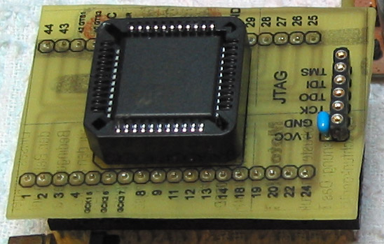

I do hope you don't mean solderless breadboard though-- those are the worst of all worlds for digital.
True and true, especially with CPLD’s I found out the hard way. That’s also a reason I made MARC-1, to get rid of the whole computer on a breadboard. While replacing glue logic and adding 65SPI, things simply didn’t work until I placed a lot of bypass caps. Without help, I was clueless.
nyef wrote:
Or there's the approach of using a soldertail PLCC socket and just sticking it into wire-wrap pin headers.
I did something like that. The first approach was an adapter from PLCC to DIL.
The second approach was an adapter using pinheads (I believe that’s how they are called)
Marco
