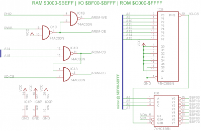

I’d like to implement this memory map:
0000-BFFF RAM
C000-FFFF ROM
BF00-BFFF I/O
I’m not sure if this can be simplified?
I took over BDD’s address qualification. Is this only necessary for the I/O block?
Marco
PostPosted: Mon Oct 14, 2013 10:14 am
Posts: 8540
You have RAM from 0 to $BEFF (which is as it should be), not $BFFF, and I/O from $BF00 to $BFFF.
Eliminate IC3E. Otherwise, RAM and ROM can get selected at the same time.
I would replace IC2 and IC3E with a 74xx521 or '688 8-bit identity comparator.
For your VADR on the '138, you want VDA=1 and VPA=0 to select I/O, because I/O always looks like data, not instructions. Having them both high is for op code fetch, which is never from I/O. You could bring one in on G1 and the other on G2A, and get rid of IC4 completely. That will leave A7 out of the picture and give you a set of mirrored addresses, but it doesn't matter. You're throwing away $BE80-BEFF anyway, which is a pretty miniscule amount of memory-map space.
Now if you just had one extra NAND section to use to replace IC3D, you could also get rid of IC3. I would simplify it more and then you could indeed eliminate two whole ICs and keep the same memory map, but I know you're going with others' recommendations about OE and WE, even though I made a commercial product without them, for aircraft no less, and we sold that model for 13 years and it proved to be 100% reliable.

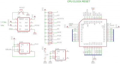

Next I’ve created a symbol for the 65816 and tried to connect it as far as I understood.
Would this be correct?
I'm not sure if I'll be using that reset IC though.

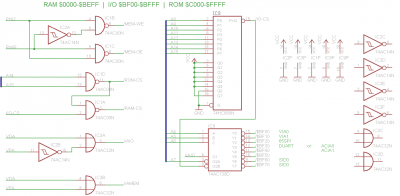

Address qualification needs to be applied to all cases, not just the I/O block. The reason has to do with how the 65C816 handles the data bus during Ø2 low, as well as the potential for false address bus states that may confuse some hardware (the 2692 is in that category). The data sheet alludes to this but doesn't really explain it well. In the following explanation, && means logical AND, || means logical OR and ! means logical NOT.
The general rule to follow with the '816 is that no RAM, ROM or I/O should access the data bus unless the expression Ø2 && (VDA || VPA) is true. If the condition is !Ø2 && (VDA || VPA) then the '816 is multiplexing the A16-A23 component of the effective address onto D0-D7, which constitutes a write operation by the '816, regardless of the state of RWB. Therefore, a chip's /OE or /WE (output-enable or write-enable) should not be asserted when Ø2 is low, as the bit pattern on D0-D7 would be A16-A23 at that time. If a chip's /OE is asserted at that time bus contention will occur. If /WE is asserted, the A16-A23 bit pattern will be written into the device. The lone exceptions to this rule are WDC's 65C21, 65C22 and 65C51, which are slaved to Ø2 and "know" what the bus states are during the instruction cycle.
As a general rule, note that no RAM, ROM or I/O should ever be selected unless VDA || VPA is true, as otherwise the address bus may be invalid. This applies to the WDC I/O devices, as well as others.
As Garth noted, you normally wouldn't expect the '816 to be fetching instructions from the I/O block. I don't make that distinction in POC V1.1, but it should be made to forestall accidental access to I/O device registers during an opcode fetch that is directed to the I/O block caused by an errant value in PC. Opcode fetch is indicated by the expression VDA && VPA being true. So if you want to be really careful with I/O device selection, only allow it when the expression VDA && !VPA is true.
To summarize, the possible states of VDA and VPA, and what they mean are as follows:
VDA    VPA    Ø2
 0      0      X   buses are invalid
 1      0      0   data address setup: DB —> D0-D7
 X      1      0   instruction address setup: PB —> D0-D7
 1      0      1   data read/write
 0      1      1   operand read
 1      1      1   opcode read
X = don't care
In the above, DB refers to the data bank register and PB refers to the program bank register.
OK, than I can change it back to the previous version to prevent access whenever PHI2=0.
• no RAM, ROM or I/O should access the data bus unless the expression Ø2 && (VDA || VPA) is true
• /OE or /WE (output-enable or write-enable) should not be asserted when Ø2 is low
• no RAM, ROM or I/O should ever be selected unless VDA || VPA is true
• careful I/O device selection, only allow it when the expression VDA && !VPA is true
VDA    VPA    Ø2
a 0      0      X   buses are invalid
b 1      0      0   data address setup: DB —> D0-D7
c X      1      0   instruction address setup: PB —> D0-D7
d 1      0      1   data read/write
e 0      1      1   operand read
f 1      1      1   opcode read
X = don't care
So I/O selection applies to d. I named it VAIO (= VDA && !VPA)
(For simplification I could use VDA || VPA as you did on POC1.1.)
However, for accessing RAM, it could be data, an operand or an opcode. That applies to d, e and f.
In that case the expression VDA || VPA must be true? And can be connected to CS2 of the RAM. I named that VAMEM (= VDA || VPA)
I haven’t done any simplification yet.

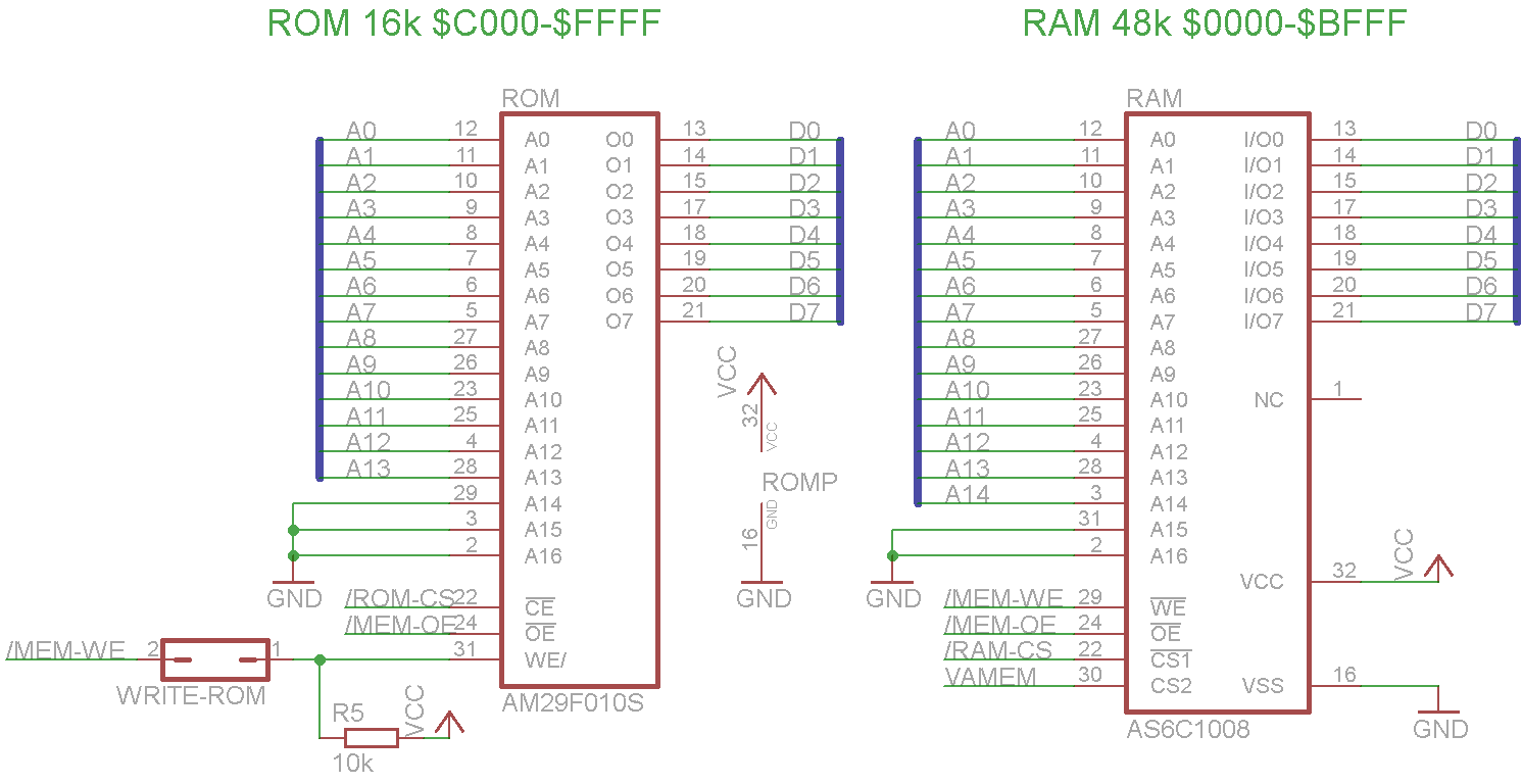

Since my ROM is actually Flash memory, and has no second Chip Select, I need to include VAMEM into /ROM-CS. Right?

We have debated VPA and VDA before: while BDD holds his line, an alternate and reasonable view is that you don't normally need to use them. BDD got burnt once with an unusual situation, and has taken a very conservative line. That's fine, if it's known to be a very conservative line.
You very probably don't need them, so if it makes your design more difficult, know that there's two ways to do it!
Specifically, if an unwanted read can never cause trouble, or if you never access addresses near I/O devices using indexed addressing, you'll be fine.
