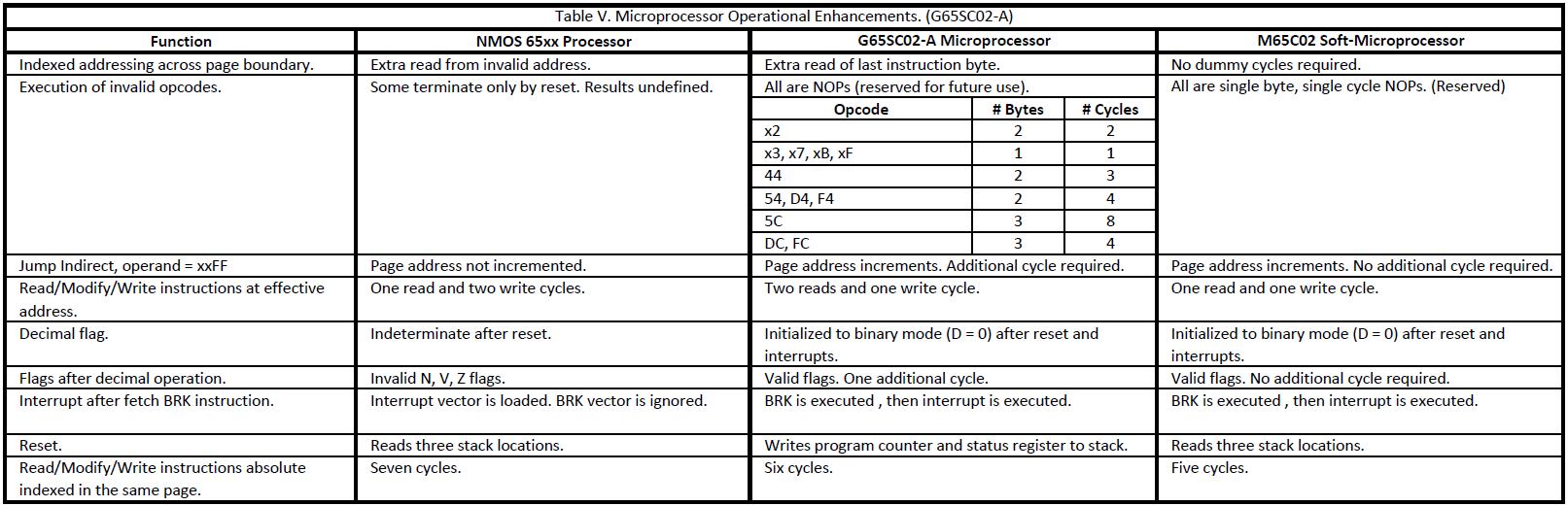

I agree with RichTW and others that the instructions for the original 65C02 are the best. I only added four Rockwell instructions and two WDC instructions (WAI and STP) after getting all of the original instructions working first, and then only to be compatible with the current 65C02 processor from WDC.
The Rockwell instructions are not particularly difficult to implement, but I did shoe horn them into my implementation. WAI and STP are also not particularly difficult to add. Neither WAI nor STP are easily tested with a functional test program such as Klaus', but some simple test logic in your FPGA should suffice.
Note that eliminating column 2 instructions, as BigEd refers to them as, you will also eliminate the LDX #imm instruction. I think that all of the original 65C02 instructions are useful and should be implemented. I can't provide any data on the utilization ratios of any instruction. I've looked and have found no published studies on the average usage rates for the various 6502/65C02 instructions.
Garth pointed me to the datasheet for the 65SC02. In the datasheet there's a table that tabulates the differences between the NMOS 6502 and the 65SC02. I reconstructed the table in the spreadsheet to which I provide you a link earlier. I've printed it out and attached it below. It's one of the few places that explains how many bytes and processor cycles are used by the unimplemented opcodes of the 65C02.
From your comment regarding finding enough single byte opcode space, I imagine that you are looking to extend your core with specific instructions. The table shown below indicates that the opcodes 03...F3, 07...F7, 0B...FB, and 0F...FF are all treated as single byte, single cycle NOPs. Eliminating the 32 opcodes used by the four Rockwell instructions will give you 32 single byte opcodes.
Although, I've not taken the time to implement the necessary changes yet, I think that the '816 stack relative mode implemented using 03...F3 is also a good extension to include. I will likely tack those instructions on to the instruction set of my 65C02 core in the near future, and pull the Rockwell instructions out.

PostPosted: Thu Sep 05, 2013 9:18 pm
(oops - I'd not want to lose LDX #imm, of course. Perhaps it could be relocated)

All,
I will consider omitting BBS, BBR, RMB, SMB, but they appear easy to implement and my plan allows for more opcode space via prefix bytes anyway.
MichaelM,
Thanks for the attachment. Do you have a Verilog core of your own?
