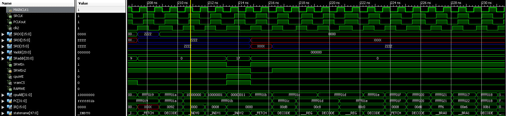

I just about have the screen capture utility installed so I can show some waveforms soon from ISim.
Today after work I was looking the waveforms from the project and noticed, according the SyncRAM datasheet, that that clock was inverted. So I fixed it and the videoDAC clock. They should be the same, but I generate 2 separate identical signals from the PLL, so if I need to delay one further I can.
The last clock to consider is the cpu clock. It is the same speed (70MHz, 14.28ns cycle time) as the pixel clock going to the videoDAC and SyncRAM. I made it so that the cpu clock goes high about 3.5ns prior. This is an attempt to take into account for the FPGA delay for the softcore cpu.
So now, the waveforms I see in ISim are in-line with the SyncRAM datasheet, and writing to the SyncRAM is good to go as it was before. But I do not count on luck anymore.
I will attempt some pics next.
PostPosted: Sun Jun 16, 2013 1:28 am
Here are the 3 clocks SRCLK= SyncRAM, PCLKout=videoDAC, & clk2=65Org16.d FPGA softcore from ISim. The first 2 go off FPGA through DDR FF's, clk2 is the internal 65Org16.d softcore clock. I will have more tomorrow, sorry very late here.
PostPosted: Sun Jun 16, 2013 12:22 pm
Which clock are you using to clock the data/address outputs ? The SyncRAM has non-zero setup/hold.
PostPosted: Sun Jun 16, 2013 3:33 pm
Arlet wrote:
Which clock are you using to clock the data/address outputs ?...
I'm not sure how to answer your question. Which data/address outputs? FPGA to SyncRAM? or SyncRAM to FPGA?
Arlet wrote:
...The SyncRAM has non-zero setup/hold.
The address and data are present almost a half cycle before the SyncRAM clock goes high. I think I'm safe there.
I'll have more timing pics tonight for a write and read.
PostPosted: Sun Jun 16, 2013 4:02 pm
FPGA to SyncRAM.
The address and data are present almost a half cycle before the SyncRAM clock goes high. I think I'm safe there. I'll have more timing pics tonight for a write and read.
Ok, good. Maybe you can reduce the setup time later, but for now it's good to be extra safe. I'm surprised the SyncRAM doesn't have zero setup/hold times.
PostPosted: Sun Jun 16, 2013 4:15 pm
FPGA to SyncRAM is clocked by clk2. clk2 runs the cpu and blockRAMs. I forget if it is running the SRAMif module, I'm away from the project at the moment. It is skewed/i.e. phase shifted to account for the FPGA delay.
EDIT: The SRAMif module is clocked by clk2.
