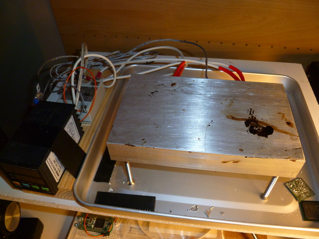

How much cost and what parts were involved in your PID hotplate custom construction? I think you laid out a few parts for your thread in the hardware section? or somewhere, but not really any of the full details. If I missed the thread just point there. I remember an aluminum block with 2 connections.
PostPosted: Tue Jun 11, 2013 1:37 am
Posts: 904
Parts for the hotplate:
    aluminum block. Size not too important; mine is about 1" x 4" x 7"
    pid controller
    ssr - solid state relay
    thermocouple
    heating elements - I used 2 x 500W units (it takes about 10min to heat up to 250C)
You can get these on amazon, ebay or anywhere in China. Total cost should be <$75, especially if you can get the aluminum block locally.
Make sure the PID controller can use a thermocouple - I think all of them can.
Heaters and thermocouples come in all sizes - pick one that will fit inside your aluminum block.
Once you have them, drill your block. Don't even think about using a hand drill, use a good, long-travel drill press or you'll be sorry. I was sorry - my drill press could not travel far enough, and my drill bit was too short. Needless to say, using the wrong tools just makes your job harder - each hole required readjustments of the drill press mid-drilling.
Then insert heating elements and the 'couple. Mine was big enough for 2 heaters - a single one for a smaller block is probably fine. The thermocouple hole was threaded, the heaters just pressure-fit into holes.
The rest is making electrical connections and deciphering the PID instructions. I used the default PID tuning settings - it's good enough. Pulses the heaters about once per second.
I am not sure if the hotplate is really better than an oven. For experimenting, definitely - you can see your board better. But an oven is better for attaching lots of chips on both sides of the board.

I ordered my hotplate! Was just a little over $83. I had to make a different design because of the aluminum block was 8 5/8" x 6" x 1" for $30, shipping was almost $20! I don't think I'll ever make a board larger than that. I choose 4 x 300W heaters for $21. And PID controller for $32. Since each element is just over 3.1" I wonder if a little bit of the element protruding from the block would be ok?
I like what Garth said about filling in vias. Maybe it's not "professional", but that is something I would try. Maybe mark off equal lengths of solder to put into each hole
