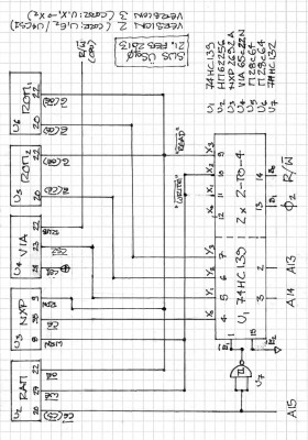

I've spotted another error on your decoding schematic. On the 74HC139, the WRITE' line should connect to the X2 output not the X1 output (Pin 10 not Pin 11). Pin 11 will pulse low when Phase2 is low and R/W' is high - i.e. at the start of every read cycle. Pin 10 pulses low when Phase2 is high and R/W' is low, which is what is needed for a WRITE' pulse. Sorry I didn't notice this sooner.
Ay. Thanks, life is crazy at the moment, will try to get around to correcting it ASAP. Also, I am now the proud owner of a bunch of '139s, so at some point I hope to be breadboarding the design out of general principle.

So I've breadboarded the chip select logic -- that mess of wires on the included photo. The chip in the middle is the '139 line select, the one on the bottom left a '132 for the NOT signal. The contraption on the small breadboard the top is another '132 with two of the NAND gates combined with a capacitor to produce a "blink" signal to simulate Phi2. The dip switch on the bottom is A15, A14, A13 and R/W' from left to right. There is some basic color-coding, with white address lines, blue write, grey read, and yellow control. The LED block is taken from the schematic, with RAM, UART, VIA, ROM2 and ROM1, in that order.
Yes, this is quite clear once you see the circuits do their thing (though the blinking lights are far more pretty in the original version). Thanks again.
(I have no idea why the schematic is on its side, it's fine on my MacBook here. Sorry.)
