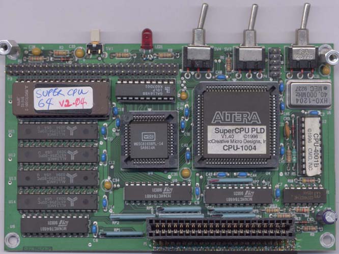

I do have a SuperCPU, but I don't know all too many technical details about it. It's got a CPLD on board as well to handle all the glue to the C64's bus.

White Flame, if you could take some photos of the SuperCPU circuit board I'd love to see them! Especially if we can make out the component numbers.

It's unfortunately packed away right now, but GIS seems to know about it:

If one looks carefully at the picture a 40 MHz clock generator can be seen (a flop somewhere is dividing that to produce a Ø2 clock), but the 65C816 itself is a -14, meaning 14 MHz. I'm not familiar with the SuperCPU's design but do know that it did run reliably at 20 MHz. The performance speedup on a C-64 bordered on the ridiculous. Using a FOR-NEXT loop in BASIC as a time delay device was an exercise in futility. :lol:

Thanks for the photo WF!
It led me to some info: I've started this new thread.

ps- thanks, White Flame, for posting the SuperCPU photo!
