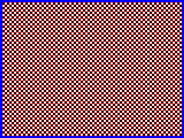

I made a github repository for this project, and added some refinements and bug fixes. Among other things, the test bench will create .ppm files with screen shots. Here's the output from the test image:
PostPosted: Mon Dec 03, 2012 7:23 pm
Ah, very cool test. So no worries of simultaneously switching outputs on this design even with the small SOT-223 VReg's? :lol:
I got a successful output after I'd realized that I had to pull up DACBLANKn, since I use v1.0g. I would've responded earlier when I first tried. But I had realized my issue, then had to run some errands. So now it works.
Do you use the R5,R6 & R7 impedance matching resistors?
When do you anticipate your SyncRAM arriving?
PostPosted: Mon Dec 03, 2012 7:36 pm
Do I need to pull up DACBLANKn too ? I never paid any attention to it. This isn't the worst possible test for SSOs, since there's a 1 pixel red line between the black and white pixels, so only a maximum of 11 switching bits at the same time. In any case, the problem would not be with the SOT-223 regulator, but rather the inductance of the traces (including the ones inside the TQFP package). By the way, since I don't have easy access to 3.3V supply, I just patched the output of the 3.3V regulator into the 3.3V input on the board, so the single regulator is powering both video DAC and FPGA. So far, so good :) If it gets too hot, I'll add a beefier regulator on the board somewhere.
I did mount R5-R7, but since I didn't order any 75 Ohm resistors (I figured I'd just pick the resistors from my standard set, until I realized there were some non-standard values), I mounted two 150 Ohm resistors on top of each other.

PostPosted: Mon Dec 03, 2012 8:03 pm
Arlet wrote:
Do I need to pull up DACBLANKn too ? I never paid any attention to it...
No, it was commented out in the .ucf file you're using for v1.0h. In that version the pin of the FPGA now goes to the MSB of a 4MB SyncRAM.

PostPosted: Mon Dec 03, 2012 8:10 pm
BTW, with your new vga module that generates HSync and VSync, I now see the blue border on the TFT and older style CRT monitors. The TFT was trimming the visible borders out with the older vga module.

PostPosted: Mon Dec 03, 2012 8:24 pm
Strange. There should not be a difference in the actual timing of the sync pulses. Of course, since your module was sending different pixel data than mine, that may cause some differences in the way the image gets displayed.
