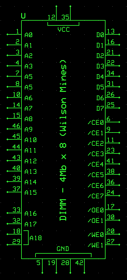

Incidentally, for those who are interested in Garth's DIMM and use Express PCB for schematic and board layout, I furnished Garth with an EPCB-compatible schematic component to add to your library. I should have the PCB component available soon. An image of what the schematic component looks like in EPCB is below.
I've also generated a matching PCB component file, which appears in EPCB as follows:
The component layout accounts for the off-center nature of the DIMM when plugged into the socket—I carefully measured the assembly with calipers to get the exact dimensions. Keep in mind, however, that due to the pin layout, the DIMM may be plugged in with the opposite orientation without loss of function.
Here's a ZIP file containing both schematic and PCB component files, which should be copied to wherever your EPCB custom components are located on your system. You can also get this ZIP file from Garth.
dimm.zip [26.36 KiB]
Downloaded 130 times
