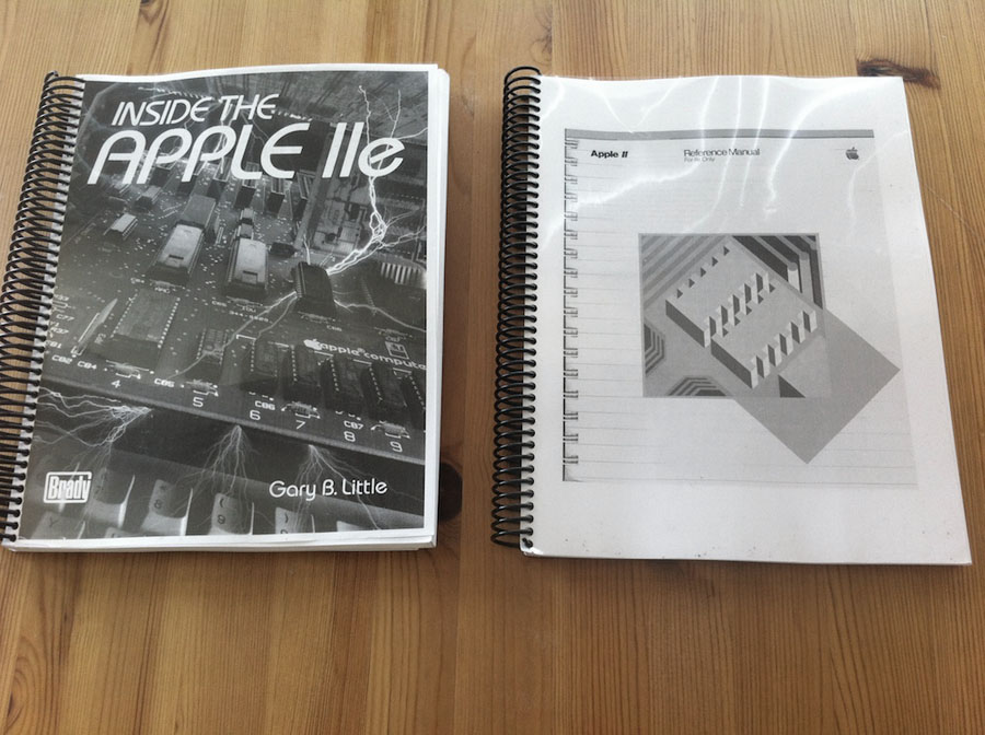

The two books recommended ("AppleIIe Reference Manual" as well as "Inside the IIe") were very useful. Since they were very old, I was unable to find them anywhere: I had to use pdf and fedex kinko:
But I now have a much better understanding of the softswitches. The bank switching system is an horrible mess but whatever.
