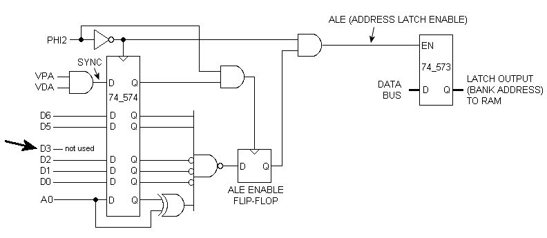

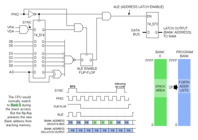

The circuit below detects RTS opcodes and forces the resulting "stack" memory accesses to remain in the program bank instead of going to Bank 0. Basically, Forth runs in a non-0 bank, and most of bank 0 must be left available for the hardware stack, since it will not be known what the value in the Forth program counter (IP, held in register S) is when an interrupt hits. Stack operations relating to the interrupt will write to and read from bank 0, while RTS serving as Forth's NEXT reads the bank that the program is in, rather than bank 0 where the hardware stack resides.

For ease of discussion let's assume we have a machine with 128K of memory -- a single 128KB chip, perhaps. The RAM's A0 - A15 inputs are fed straight from the CPU, and A16 comes from an Address Latch. This is S.O.P. All '816 systems using multiple banks require an Address Latch to capture the bank-address information that appears on the data bus during the first half of every bus cycle.
Our goal is to use memory "at" SP in Bank 0 for short-term read/write storage, and to use memory "at" SP in Bank 1 for the Forth address lists. So, we reserve a large stack area in Bank 0. We set the '816's Program Bank Register to 1 and we load the address lists into Bank 1 (and the callee machine-code routines, too). We set SP to point to the desired address list.
By using two banks we've provided two separate storage areas, as required. Normally RTS would be unable to access the address list, due to the CPU's policy of steering all stack-related operations to Bank 0. RTS will cause the CPU to do a pull, but it would normally be from Bank 0. To correct this, the circuit above detects RTS opcodes and forces the resulting "stack" memory accesses to remain in the Program Bank instead of going to Bank 0.
The '574 octal register captures eight signals at the end of every bus cycle. No action results unless the bus cycle is an opcode fetch (SYNC =1). If SYNC =1 the flip-flop may change state in the cycle following the opcode fetch.
If RTS (opcode $60) is detected then the D input will be low and the flip-flop will be cleared. Clearing the flip-flop has the effect of discontinuing pulses on ALE, the Address Latch Enable signal. The latch ceases to update cycle-by-cycle as it normally would, and the most recent update (indicating the Program Bank) "sticks." All accesses are forced to the Program Bank, and we get the desired effect of RTS pulling an address from the Program Bank rather than Bank 0.
    Note-
  • The circuit as shown is a little sloppy in that it's triggered by opcodes $70, $E0 and $F0 as well as $60. That turns out not to make any difference, since those other instructions access only the Program Bank anyway.
  • The XOR gate protects against an obscure hazard: the false opcode fetch that occurs whenever an interrupt is recognized. There's a risk that an RTS opcode will get fetched but not executed. If this happens the circuit mustn't respond; ie, the flip-flop needs to remain set. To recognize the beginning of the cpu's interrupt sequence we look for the unique circumstance of the address bus failing to increment in the cycle following an opcode fetch. (See Table 5-7 of the '816 Data Sheet) No increment means the least-significant address line, A0, will fail to toggle. The output of the XOR gate will be low and the flip-flop will remain set (allowing a successful interrupt with machine state pushed to stack in Bank 0 where it belongs).
So! The upside is that 6-cycle NEXT is all that we'd hoped: we can aim SP at a list of addresses and use RTS to rapidly "Call" each routine in sequence. JSR opcodes are not required, slashing Call overhead from 12 cycles to 6. Explicit pushes & pulls can be used for short-term storage, and interrupts are fully functional. The downsides are:
  • you need hardware mod's or a built-from-scratch machine
  • The large (and mostly unused) stack area that must be reserved in Bank 0. That's required because for all addresses pointed to by SP in the Program Bank, those corresponding addresses (and some additional bytes below) in Bank 0 are subject to being written at any time by interrupts. Also SP must avoid addresses corresponding to Direct-page, I/O ports and any other sensitive areas in Bank 0.
  • Forth's Return Pointer will have to reside in Y or in memory.
When coding, you need to bear in mind that SP gets altered every time an RTS (ie, NEXT) executes! Nevertheless, pushes and pulls (PHA & PLA, for example) are permitted provided that you put SP back where you found it before the next NEXT occurs. The Bank 0 allocation for stack will be wastefully large. Luckily, memory is cheap -- and there's nothing to prevent us populating additional banks.

Cool! I'm happy to see some actual code snippets. On the other hand I'm a little embarrassed, because your code samples show that I've been short-sighted. RTS shouldn't be the only means to do a pull from the Program Bank. We also need to be able to pull from the Program Bank to some other register (A, X or Y), not just to the PC (which is what RTS does).
PLA looks like it'd be a good choice to share the "use Program Bank" attribute with RTS. The circuit can certainly be modified to allow both RTS and PLA to behave this way; in fact the similarity of the opcodes ( $60 vs $68 ) makes the mod pretty trivial. So if we want to play with the idea of 6-cycle NEXT assisted by hardware, let's assume RTS and PLA both pull from the Program Bank.
The revised schematic is here:

Well, to add the hardware mod to an existing '816 system would be a little messy but not too bad. A person would have to tap onto the data bus and a few other signals. The only slightly nasty bit is having to cut the trace that supplies the Enable signal to the system's Address Latch (so that the mod circuit can take over as the new source for that signal).
As far as other targets for your RTS-powered Forth, built-from-scratch '816 systems are eligible, of course. 6502 systems that've been retrofitted with an '816 could certainly run the RTS trick. To also have the mod (and the use of interrupts etc) you'd also install some additional RAM and at least a one-bit address latch.
Re: the matter of allowing PLA to access the Program Bank (as mentioned in my previous post), I've updated that post to include a revised schematic. The revision consists simply of removing all reference to D3, which for our purposes becomes a don't-care. The revised circuit triggers from opcodes $60 and $68 as required, and also spuriously but harmlessly from opcodes 70, 78, E0, E8, F0 and F8.
To implement the mod using discrete logic I'd suggest using a 74AC138 as the 6-input NAND gate. Also the delay from PHI2 to ALE should be kept short, so a minor change may be in order there.

The solution is to use the 65C816's facility for multiple 64K banks. For example, 4001 in Bank 0 is distinct from 4001 in any other bank, and that's what saves the day. All we have to do is tweak the CPU's policy of steering all stack-related operations to Bank 0. For example we allow the CPU use 400_ (whatever) in Bank 0 when an interrupt occurs, but the hardware mod forces activation of 400_ (whatever) in the Program Bank when RTS accesses the list. That's how we manage to use the SP register for two different functions.
What is perhaps counter-intuitive about the scheme is that SP is somewhat of a loose cannon; we have very little control over where interrupts will write to! All we know for sure is that PC and P will get saved in Bank 0, and it'll be somewhere in the region of Bank 0 that corresponds to the region that holds the address lists in the Program Bank. The diagram below illustrates the two corresponding regions.
The address lists might be a dozen or so Kbytes in size, and the corresponding Bank 0 region slightly larger -- certainly far more memory than any interrupt would need. Nevertheless, the uncertainly about SP forces us to reserve that amount solely for interrupt usage -- a wasteful yet reasonable tradeoff, given memory prices nowadays.
