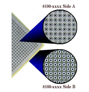

Even if the motherboard is wire-wrapped (if WW will work at all at these speeds), it should be done on perfboard with plated-thru holes and a plane on at least one side, like this one from Twin Industries:
Image Edit, leaving the old URL to rattle their cage:
This lets you solder a chip capacitor from a pin to the surrounding ground plane. This board is less than $20US for 4.5"x6.5", and less than $12US for 4"x6". 4"x10" is priced at $23.60. They also have ones with planes on both sides for the same prices, which is way cheaper than Vector used to have them.
If the mother board doesn't have a ground plane, I don't think cap.s between the pins will do much good.
