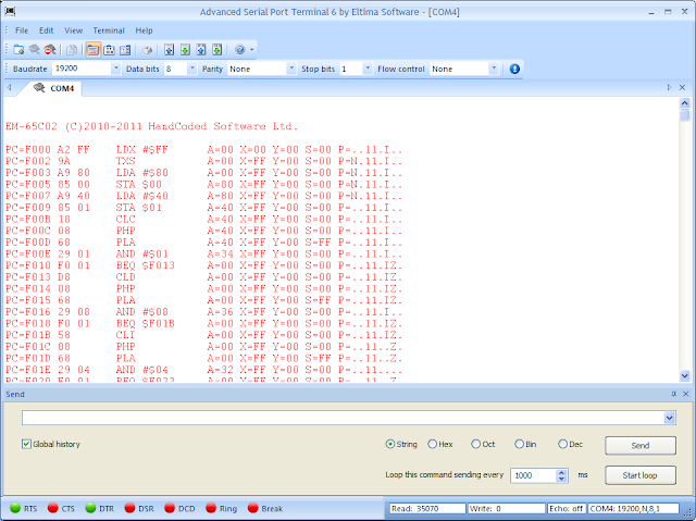

Post by BitWise »
It lives ...
Trace output generated via the UART
Andrew Jacobs
Posts: 11464
Excellent! Looks like a test suite...
