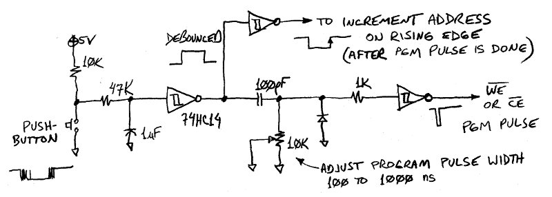

How about something like this:
I have not breadboarded it to make sure I don't have any errors, but that's what I would start with, then use the oscilloscope to set the programming pulse width. A 28c64 data sheet I found said the width should be 100ns minimum and 1000ms maximum, and the trimmer pot will cover this approximate range nicely. The programming pulse will take place as soon as the button is pressed and held for the debounce period. The debounce period is approximately 1/20 of a second. The address will be incremented right after you take your finger off the button and keep it up for the debounce period (about 1/16 of a second), which will be plenty of time after the programming pulse is finished. The timings will vary from one 74HC14 to another since they do not have a guaranteed hysteresis size. I would recommend the HC14, not the HCT14, because we want the symmetrical input voltages.

OK, today i have implemented the denounce circuit using NAND gate....
it is working well and i have also cascade the 1983 chip but when taking out the carry to the input of counter of 2nd 193 chip it has 1 on its output .....
so when it start add. the 2nd chip shows 1 which should be 0.
I think i need, NOT gate to reverse the direction voltage level or with transistor..

The 2864 is working quiet well i have tested it with my counters and the chip is storing data also....!!
and i want to know is there any limit of time in whichthe write pin should be triggers?? as in data sheet it is mention for nana sec. but here i am using it foe sec......So, please clear this doubt..!!
1 nanosecond = 1/1,000,000,000 of a second. With the circuit I posted, the timing requirements will be satisfied with wide margins.
