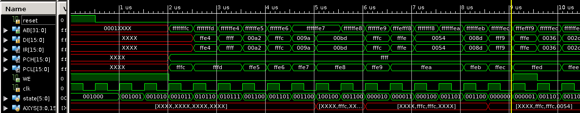

Well, I finally did some hacking this afternoon, using Arlet's core as a basis, and it does seem to be relatively straightforward to cook up a version of 6502 with 16-bit registers and a 32-bit address space. The way to look at this is as a 6502 where a byte has 16 bits. There is no particular support for an 8-bit data type or peripheral - you roll your own.
This is of course very early - not even proof of concept.
(Edit: this project now on github as a friendly fork of Arlet's project. See also this summary of 65Org16 threads.)
Anyway, here's a trace: the cpu is running from a tiny ROM, hand-assembled into 16-bit opcodes. Mainly a question of zero-padding with a sprinkling of sign-extending. A usable assembler would be one of the things needed.
File comment: Traces from a simulations - originally http://img641.imageshack.us/img641/4797/65org161.png
Question is: who's genuinely interested in a 6502-like CPU, implemented on FPGA, which can address up to 4 gigawords of 16-bit wide memory?

Just a tip for simulation: if you define 'SIM' (or remove the `ifdef), you can add A, X, Y, and S registers separately. That makes it easier to see what's going on.
`ifdef SIM
wire [7:0]   A = AXYS[SEL_A];           // Accumulator
wire [7:0]   X = AXYS[SEL_X];           // X register
wire [7:0]   Y = AXYS[SEL_Y];           // Y register
wire [7:0]   S = AXYS[SEL_S];           // Stack pointer
`endif
Since you now have 16 bit instructions, it would be nice to add some more registers. Since the core is already using a register file, with enough resources to support 16 registers (only 4 are used right now), you can easily add 12 more without much impact on core size/speed.
The 16 bit ALU is certainly going to slow down max speed, due to the longer ripple carry path. If you care about speed, removing BCD support should help a bit there.
I'll do that - it's the one incompatibility I'm happy to commit on day one.
But ideally this core shouldn't be significantly slower than yours - double the width should only add a gate delay if we can get a fast adder implementation. (Seeing 43MHz vs 46MHz on a xc3s200-4, 368 slices vs 263.)
 Post subject:
PostPosted: Tue May 03, 2011 8:08 pm
The ripple carry path will add 16 extra gate delays (2 per bit), but these are dedicated gates, and they're quite fast compared to regular LUT delays. If the place & route puts all 16 bits next to each other, there won't be any extra routing delay either.
43 MHz vs 46 isn't all that bad.
