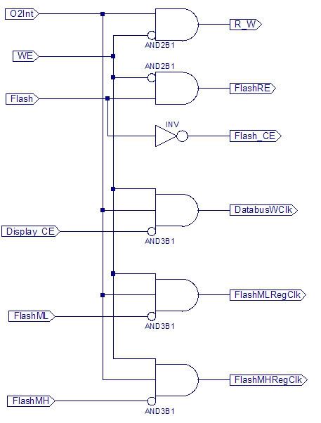

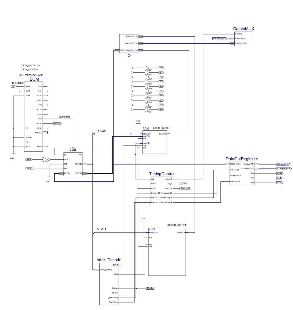

Garth, I've looked at dual-port RAMs too (external to the FPGA), and most of the larger ones like 2M have wide datapaths, like 18 or 36 bits, and come in 400+pin BGA packages... The smaller 8 bit data path devices are very limited in memory depth. I've seen 128K MAX on Digikey.com. Maybe more searching is in order...
I think we're on to something there with the dualport Rams... But I'd like to know why the big discrepancy between the depth and width of dual port RAM's, synchronous or asynchronous...
The FPGA I'm using, XC3S400, has a maximum of 32K internal RAM... It shows how limited these FPGA's are, when it comes to internal RAM... The block RAMs are probably best used for zeropage/stack/+more than a few data registers and the core's ROM.
To all: What if the VGA interface is a write to only type of interface? Why would one need to read from a display anyway? Unless it's a gaming type system where you need a sprite type collision register?...
I'm gonna check out some arcade schematics and parts for ideas...
 Post subject:
PostPosted: Sun Mar 20, 2011 11:48 pm
I couldn't find a decent sized dual port SRAM for a video graphics application. So now I am on a different tangent of thought...
It'd be nice if Xilinx could have another FPGA family that would have a high density SRAM with some logic to control it, instead of high density logic and just a little RAM. Finally put DRAM to rest.
BigEd, thank you for your ramblings!, I think we all need to ramble more so I'm gonna, and try one of those 6845 cores, maybe search for more... But since the video RAM will not be part of the FPGA, I do need to figure out the READ timing of Arlet's 6502 Core (his core is most likely THE fastest core, if you can do everything internal), which I intend to do with the FLASH I mentioned before, hopefully in the next couple days. The WRITE timing I have already proven with the TFT display and max'd it (the TFT display) out @38MHz...
Just so I don't mislead anyone following this thread, I am developing a write only type of graphics system that will transfer information to a user at the highest speeds. The other side of the spectrum would be a gaming type system that would need to read & write to the video RAM, because their user is controlling sprites and interacting every millisecond.
In my concept, the CPU only writes to the video RAM based on input from keyboard only. Data inputted from the FLASH/SD Card is only allowed under command from the keyboard. The video controller only reads from the video RAM and constantly shifts out pixel data. The easiest type of data transfer from the CPU to video RAM would be during an inactive Display Enable. Initially, I'm sure this would work, but I would like to delve abit further after I get to this point.

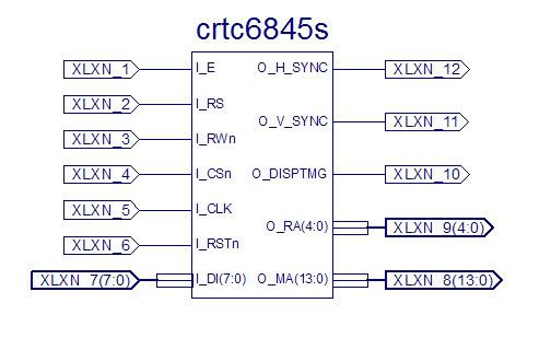

Here's the code from BigEd's second link to pacedev. I had to clean it up. There were just a few syntax errors ISE did not understand.
Is there a way to make a scrolling window for the code?

And the symbol:
Looks like DISPTMG is Display Enable? And there's no DataOut so the registers are write only.

The datasheet contains a block diagram of how a 6845 might be used.
The O_DISPTMG stands for 'Display Timing' - in the datasheet it's DE, meaning 'Display Enable' and yes, it signals the active period. That allows you to output a border colour, which was useful when displaying to a TV.

I've had to change quite abit of the schematic. There are I/O buses cropping up everywhere! 2 data buses for the flash, 1 for the TFT. I am beginning to understand why the pin count is so high on these FPGA's. I'm learning that each typical external parallel memory/peripheral needs 2 buses each. One for reading, 1 for writing.
So after adding all this one step at a time, using the same constraints, it worked almost perfect. All the additions were transparent, which is what I was hoping for. The screen does locks up randomly after more than a few screens of data have been sent, just like before I lowered the DRIVE constraint to 4 mA. And I don't feel comfortable lowering it more, so...
Now is the time for all good men to come to the aid of their country! Uh, I mean to say, now I'm gonna add some bypass cap's. Unavoidable now. :(
Still very short on resources being used on this XC3S400 beast! This is the top_level schematic. Will post a pic of resource usage after I have 100% success with the Flash and TFT working together... Sorry for the large pic but I think it's necessary to see the detail, plus BigEd said I could. :lol: :

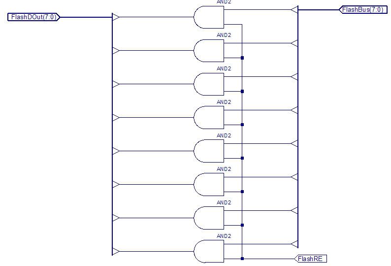

The DataInMUX symbol in the above schematic (Thanks to Tony & Garth, I had a flashback to this): I had to make the databus inputs from the external Flash be all '0' when it was inactive, in order to conform the the internal data structure. Initially, I was thinking of 8x 2to1 MUX's, but this worked very nicely.
Timing control: O2Int is the 38.86MHz 02 internal from the DCM. R_W goes the the TFT. Flash, Display_CE($C000-$C001), FlashML($C002), and Flash MH($C004) are from simple addressing decoding. DatabusWClk, FlashMLRegClk, and FlashMHRegClk are clock signals going to flip flops.

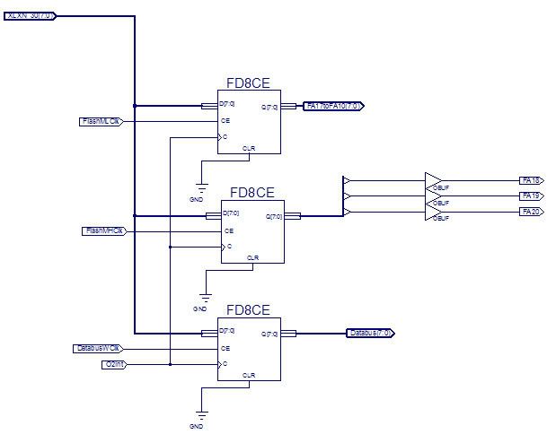

Data Out Registers:

Parts of the schematic have changed but from now on I plan to post schematics only at the end of a "chapter". This chapter being reading and writing and erasing the Flash.

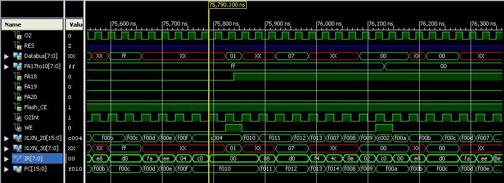

Now that I've got the OK to have the laptop at work I've been able to dedicate considerably more time to this project when work is slow, which is quite often unfortunately/fortunately?. With ISim, there's no need to have the actual hardware to do testing. ISim has been a HUGE asset.
I'm at the point now of presenting the banked address to the Flash, using a 1K window @$0400-$07FF. A simple piece of software I am using to test my circuit is below. $C002 is the LSB and the data can be seen on FA17to10[7:0]. $C004 is the MSB, only the lowest 3 bits are used and can be seen on FA18, FA19, and FA20. I made them readable ports, so I can do a INC/DEC. On to the ISim...

It successfully does an INC but that's it. 1 time only. Also, I don't understand why there are zero's in the IR. Once, right after the INC $C004 (yellow marker), and again after the STX $C002.
Any ideas on either of these?
