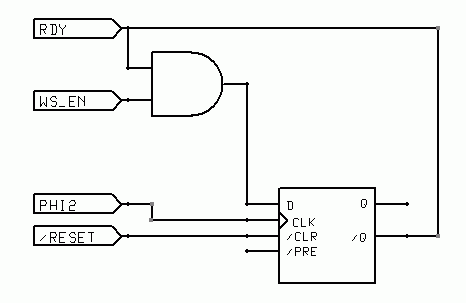

BDD,
I have successfully incorporated the two Flip-flops (FF) into the 16V8 using the design you provided. While doing so, it occurred to me that you could do this with just one FF.
You let PHI2 drive the clock input. /RESET drives the /CLR input.
You place an AND gate on the D input with the /Q output of the FF going to one AND input and the Trigger (Address decoding) going to the other AND input.
When the address is decoded as a slow device, the WS_EN input goes high. When PHI2 rises, Q goes high and /Q goes low, generating the RDY pulse. This also causes the AND gate output to go low, so the next PHI2 rising edge with set Q low and /Q high, removing the RDY.
I will update the 16V8 code to implement this setup and run the simulator.
I will post results back here when I'm done.
The use of the diode on the RDY pin is recommended to provide the isolation you described in your design. I'm not sure the tri-state output is needed unless you have more than one input to the RDY pin. However, this could be included in the new configuration as well.
Comments welcome.

PostPosted: Thu Dec 02, 2010 8:30 pm
Posts: 8509
I'm wondering if implementing this on a 20V8 or 22V10 might leave enough room for a second flop. That way the circuit could be jumper selectable for one or two wait-states. Or it might be possible to have the circuit automatically provide the right number of wait-states based upon the selected address. For example, ROM might be okay with one wait-state but two might be required with an I/O device.
In my POC V2 unit, which was designed around the wait-state circuit with the external flops, I arranged it so I could select one or two wait-states as I debugged the design. The goal is to run the thing at 20 MHz. Timing analysis suggests that I should be able to get away with one wait-state but I figured that having the ability to enable two would be a good idea, just in case my analysis is flawed.
I like your simplification and am eager to see how you fit it to a GAL.
BTW, I'm also evaluating the use of an Atmel ATF2500C PLD in my POC V2 design. Its greater capacity might allow me to combine the functions of the two GALs in the POC V2 into a one chip solution, including the flops. The 2500C is available in PDIP40 or PLCC44, the latter being stocked by Mouser and several others. Only things is my burner can't program the 2500C, so I may have to go shopping for a new one. :(

 Post subject:
PostPosted: Thu Dec 02, 2010 10:27 pm
Posts: 1043
That requires that the address decoding to detect a slow device is done before phi2 rises. That can create some timing constraints for higher clock speeds.
But actually I've used a phi2-rising-edge-based design myself, but only at max 2MHz http://www.6502.org/users/andre/icaphw/rdy.html. Oops, looking at the schematics again, I am actually using phi2 rising edge in my CS/A 65816 board as well, which runs at 8MHz :-)
So this would still work for some higher speeds, yet I'd look carefully at the timing.
Also your design automatically restricts RDY to a single cycle - which is often enough, though.
