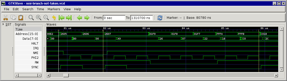

I hooked up my logic analyzer to check what was going on. First a screenshot of the expected behaviour (using a 2-cycle not-taken branch):
At ~81us the CPU fetches the BCS opcode and NMI goes low. At the end of this cycle the CPU recorded the first-low-cycle of NMI. In the next cycle the CPU fetches the offset, NMI is still low and the CPU records the second-low-cycle so interrupt execution can start. Then, in the next cycle, the 7-cycle interrupt execution starts.

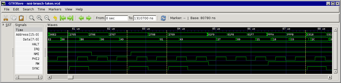

Now the screenshot of the 3-cycle branch leading to the execution of another instruction:
At ~81us CPU fetches BCS opcode, in the next cycle the offset, also NMI goes low, then the CPU executes the branch, and now the NMI should be serviced. But the CPU fetches the next opcode ("A9" / "LDA #"), and the data ("01"), and after that starts with the 7-cycle interrupt sequence.

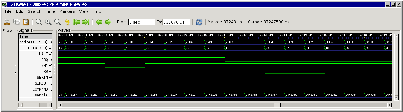

Here's another screenshot from my real-world code (sampled at Atari clock speed at the falling edge of PHI2 - ignore the timestamps at the top, they are a dummy 1us per sample). First there's a BNE backwards, followed by a "BIT $D20E" executed instead of the NMI handler:

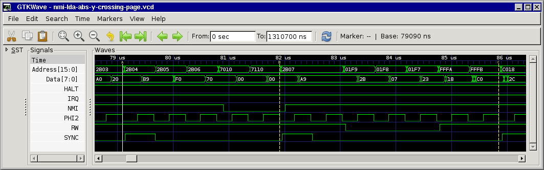

LDA ABS,Y both to the same page and crossing a page are fine. Maybe it's something specific to the branch commands or that the branches may require 2, 3 or 4 cycles...
LDA $70F0,Y not crossing a page (Y=0):
LDA $70F0,Y crossing a page (Y=$20):
so long,
Hias

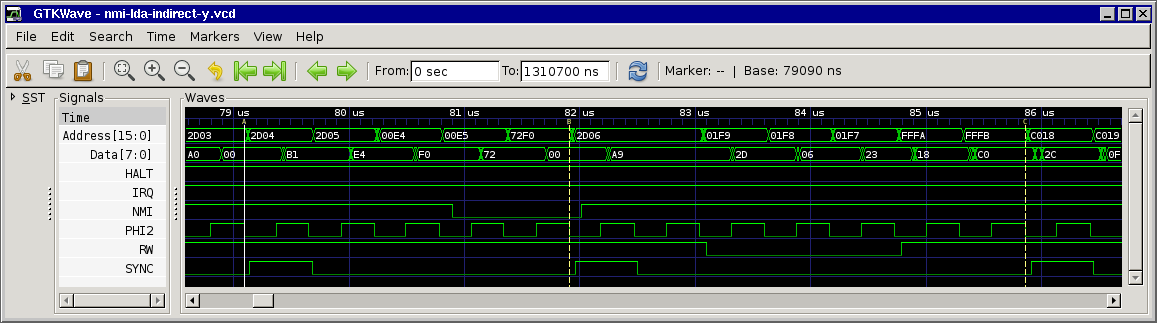

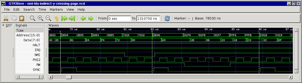

LDA (ZP),Y is fine, too.
not crossing a page:
crossing a page:
so long,
Hias

Maybe this screenshot could clarify it a little bit:
so that's:
T0 PC fetch opcode
T1 PC+1 fetch offset
T2 PC+2 dummy fetch
T3 PC+2+offset (without carry) dummy fetch
T0 PC+2+offset (with carry) code continues
