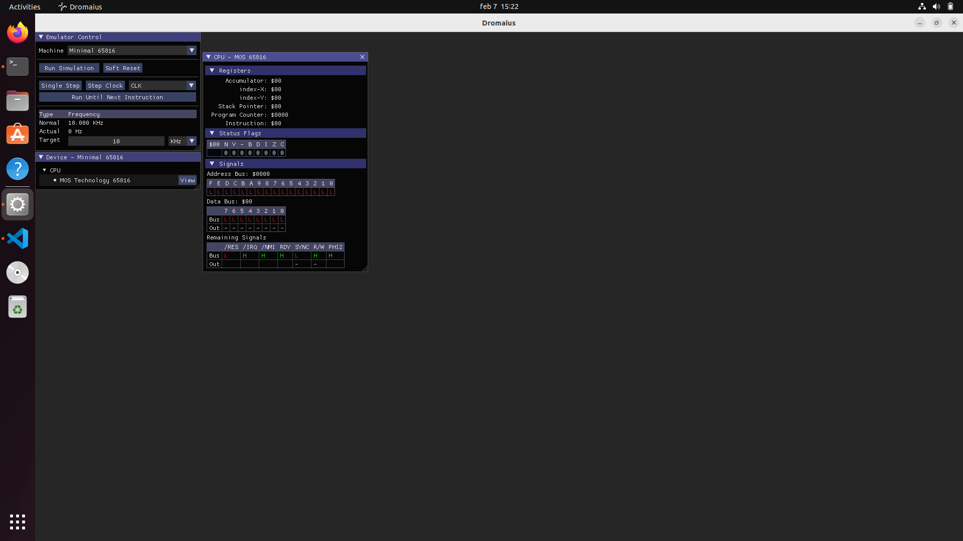

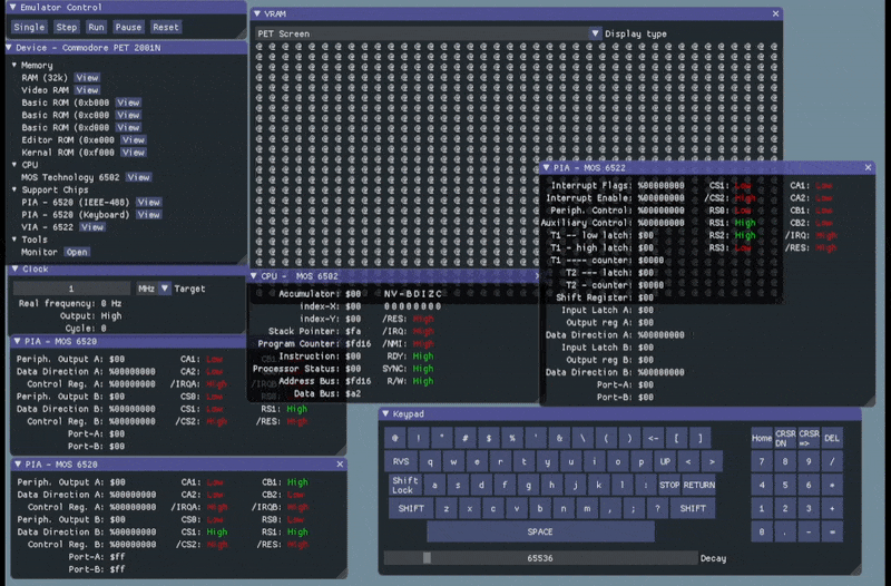

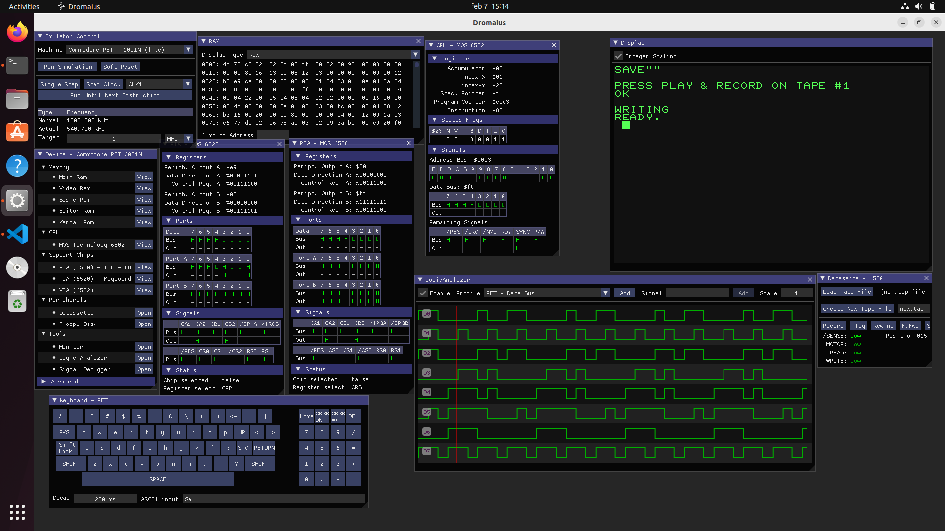

Let´s see what is my target. This is what dromaius looks like :
A full (a think) PET2001. 6520, 6522, memory, video, tape, disk, everything is emulated. You can peek into the support chips' registers, into the CPU. It also has a built-in logic analyzer. Quite an amazing setup!
As my final goal is to emulate my Nova 64, I will need to implement additional chips. I am planning to even emulate an SD Card so I can test my read/write functions. The functionality I plan to build into my main FPGA (To handle devices, keyboard, storage, mouse, DRAM) will also be recreated. The ultimate goal is to learn and understand what am I doing, so when the time comes to build real hardware, it can be less painful.
The current status of Dromaius816 is simpler.... much much simpler.
Everything has been ripped off, except for clock, reset, and CPU. It is helping me to understand how the emulator works, before creating more complicated stuff.
My TO-DO for the weekend, keep on studing the emulator core, and how the clock generator and reset generator work. As this two components don't have a panel to check their state (Not to much to check anyway) I will create them, to gain some kwowledge on the GUI itself.

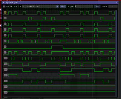

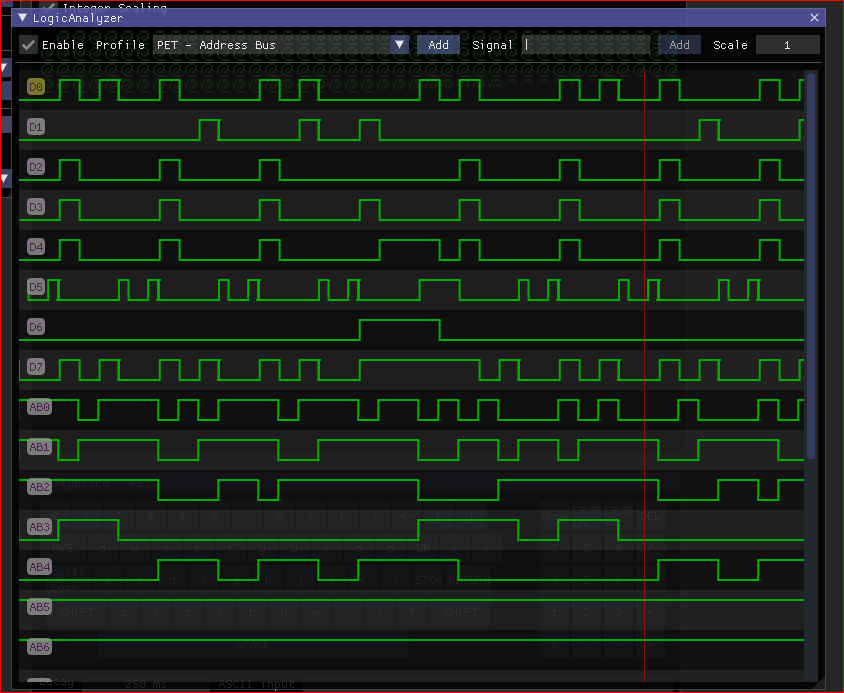

Although I still haven't started working on the 65816 emulation itself, there's been quite some progress during this last days. My kwowledge on the original emulator has been expanding everyday, and I am adding one functionality at a time to mine.
My latest addition, is the logic analyzer, which I consider quite important for my goals. In the original emulator it was only available for the Commodore Pet emulation, and other smaller systems built into the emulator didn't have that. I've managed to understand how the Logic Analyzer captures and represents data and adapted it to my own emulated computer.
One thing that was missing from the original, was the ability to plot buses as a single line. Before, each bus line was an independent signal, making them quite impossible to read.
I have modified the LA so, if it detects a whole bus is added (DB0:7 or AB0:15), it colapses into a single line, much as any LA software would do
As I said, no advances in 65816 emulation yet, but I am so happy with this feature, that I wanted to share it with the forum.
I still have some ideas to improve the LA. It has a very limited range of zoom options, and it doesn't allow scrolling. I am not going to get bored, that's for sure

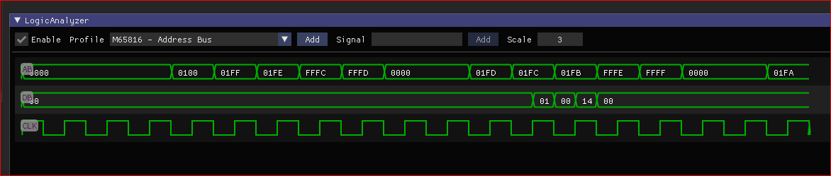

Progress!!!
One by one, all the features from the original emulator are being built into mine. Today, I managed to implement a 64KB ram into the emulation.
It may not be a huge step. After all, it is something already done, but I don't mark a feature as "Added", unless I understand how it works. Proof of this, is that I have extended the RAM form 32KB to 64KB. I had to remove some components, such as a IO chip (6520) and a 32KB ROM, and "rewire" the RAM. The original 6502 cpu seems happy about it, and runs code from it as expected.
Meanwhile, I have remove all decoding logic from my emulated 65816 CPU, so any opcode is processed as a NOP. I am working on the internal registers right now. Adding registers is trivial, extending current one is trivial too. Adding more flags to build the status register is also done. Both the emulator and the GUI are quite happy about it
My current focus is on different areas at the moment.
- Emulation flag is created and I can manipulate it in the code. It is set during the reset sequence. I want to implement SEC,CLC and XCE instructions first. When E changes, the status register should reflect the current CPU mode.
- Manipulation of M and X flags will follow. I am still learning how the CPU works. I know these two flags control the with of the accumulator and the index registers, but, honestly, I don't even know which instructions modify them. I could've looked it up while I was writing this but... I really want everybody to know where I am standing right now!
- Output of BA when needed. I could make it so BA is present on the bus during PHI low with minor changes to the emulator core. This will completely ignore some timings, but the goal is not to be absolutely exact with the timing. This is emulation, not simulation so... could it be good enough?

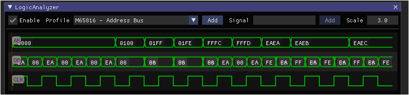

I'm attaching a capture of the startup and the first few cycles of the NOP free run. I just love the Logic Analyzer!
Cheers!

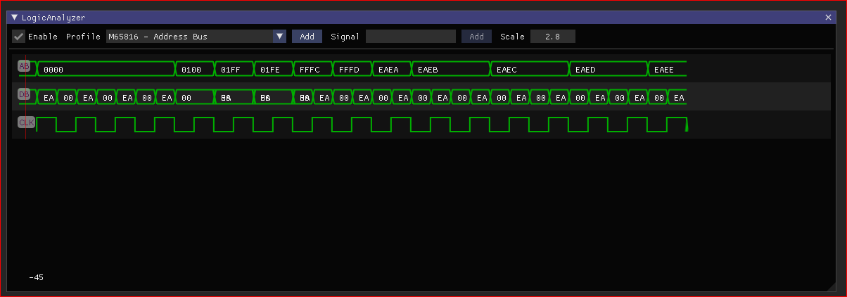

Two little achievements to add to the list.
A proper fetch/decode loop is now implemented into the emulation. On decode cycle 0, the opcode is fetched into the IR. From there on, a function is called using a function array based on the opcode. Each opcode function advances the decode cycle counter until the instruction is executed, returning the decode cycle to 0.
Only NOP is executed at the moment, so, not too much more than yesterday but now I can focus on implementing opcodes.
Here you can see a log of the CPU starting up, going through the 7 cycle reset sequence, fetching the reset vector, and executing a couple fof NOPS
Also, the BankAdress is now present on the data bus during PHI2 LOW. Not timing perfect, but on each clock transition (I think) I have the right value on the bus, and this should be good enough for my emulation.
I don't have the PBR or DBR implemented yet so, I am writing a harcoded 0xFE when I am fetching the opcode, and 0xFF when executing.
Next milestone, decoding and implementing all instructions related to mode switching (Native vs Emulation, 8 vs 16 bit registers)
Edit: Mode switching refers only to the change between Native and Emulation. Changing registers width is not a mode change. (Thanks BDD for pointing that out)

[ 2025-02-24 13:20:25.293 ] - CYCLE_END Decode_cycle: 6 IR: 0
[ 2025-02-24 13:20:25.293 ] - CYCLE_BEGIN ---- Decode_cycle: 0 IR: 0
[ 2025-02-24 13:20:25.293 ] - Fetching into IR
[ 2025-02-24 13:20:25.293 ] - Fetching eaea
[ 2025-02-24 13:20:25.478 ] - CYCLE_MIDDLE Decode_cycle: 0 IR: 0
[ 2025-02-24 13:20:25.478 ] - Fetching into IR
[ 2025-02-24 13:20:25.680 ] - CYCLE_END Decode_cycle: 0 IR: 0
[ 2025-02-24 13:20:25.680 ] - Fetching into IR
[ 2025-02-24 13:20:25.680 ] - Fetched: ea
[ 2025-02-24 13:20:25.680 ] - CYCLE_BEGIN ---- Decode_cycle: 1 IR: ea
[ 2025-02-24 13:20:25.680 ] - Address bus: eaeb
[ 2025-02-24 13:20:25.861 ] - CYCLE_MIDDLE Decode_cycle: 1 IR: ea
[ 2025-02-24 13:20:26.950 ] - CYCLE_END Decode_cycle: 1 IR: ea
[ 2025-02-24 13:20:26.950 ] - NOP Opcode ea executed
[ 2025-02-24 13:20:26.950 ] - CYCLE_BEGIN ---- Decode_cycle: 0 IR: ea
[ 2025-02-24 13:20:26.950 ] - Fetching into IR
[ 2025-02-24 13:20:26.950 ] - Fetching eaeb
[ 2025-02-24 13:20:28.270 ] - CYCLE_MIDDLE Decode_cycle: 0 IR: ea
[ 2025-02-24 13:20:28.270 ] - Fetching into IR
[ 2025-02-24 13:20:29.196 ] - CYCLE_END Decode_cycle: 0 IR: ea
[ 2025-02-24 13:20:29.196 ] - Fetching into IR
[ 2025-02-24 13:20:29.196 ] - Fetched: ea
[ 2025-02-24 13:20:29.196 ] - CYCLE_BEGIN ---- Decode_cycle: 1 IR: ea
[ 2025-02-24 13:20:29.196 ] - Address bus: eaec
[ 2025-02-24 13:20:54.275 ] - CYCLE_MIDDLE Decode_cycle: 1 IR: ea
[ 2025-02-24 13:20:54.429 ] - CYCLE_END Decode_cycle: 1 IR: ea
[ 2025-02-24 13:20:54.429 ] - NOP Opcode ea executed
[ 2025-02-24 13:20:54.429 ] - CYCLE_BEGIN ---- Decode_cycle: 0 IR: ea
[ 2025-02-24 13:20:54.430 ] - Fetching into IR
[ 2025-02-24 13:20:54.430 ] - Fetching eaec
[ 2025-02-24 13:20:54.609 ] - CYCLE_MIDDLE Decode_cycle: 0 IR: ea
[ 2025-02-24 13:20:54.609 ] - Fetching into IR
[ 2025-02-24 13:20:54.764 ] - CYCLE_END Decode_cycle: 0 IR: ea
[ 2025-02-24 13:20:54.764 ] - Fetching into IR
[ 2025-02-24 13:20:54.764 ] - Fetched: ea
[ 2025-02-24 13:20:54.764 ] - CYCLE_BEGIN ---- Decode_cycle: 1 IR: ea
[ 2025-02-24 13:20:54.764 ] - Address bus: eaed
[ 2025-02-24 13:20:54.926 ] - CYCLE_MIDDLE Decode_cycle: 1 IR: ea
[ 2025-02-24 13:20:55.075 ] - CYCLE_END Decode_cycle: 1 IR: ea
[ 2025-02-24 13:20:55.075 ] - NOP Opcode ea executed
[ 2025-02-24 13:20:55.075 ] - CYCLE_BEGIN ---- Decode_cycle: 0 IR: ea
[ 2025-02-24 13:20:55.075 ] - Fetching into IR
[ 2025-02-24 13:20:55.075 ] - Fetching eaed
